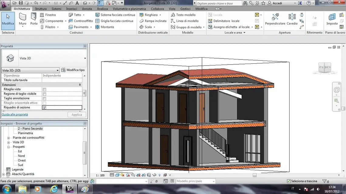

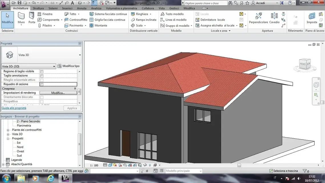

hello to everyone, today as usual a new "problem".
I'm making a double cover that should fit each other.
I can't understand what is the best way to achieve it.
I made an attempt (as visible from the attached pictures) but then jumps out a problem in the section. really the cover section is not like that.
How can I overcome the problem?
thanks in advance and good day to alliiii. . :finger:

I fear you have to create 2 separate roofs. a lower one that comes to touch the perimeter walls and a superior one that "connects" with the other roof
hi great !!! as usual you are always the first to try to solve the problems... Hehehe.
returning to us: the covers are already two because one part (the lowest one) is attic, while the other is not.
Resolutions?
Haven't you ever drawn such a thing?
I'm sorry, I meant three roofs then... but I was actually trying now on a ca22o example but similar to yours and you don't need it. That's enough. furnish the perimeter of the "capanna" up to 5-10 cm inside the perimeter wall, then with the unjoined/disjoined roof command join the 2-phalt roof with the pavilion. last step, join (join geometry control) the two-phalt roof to the outer wall on which it rests.
