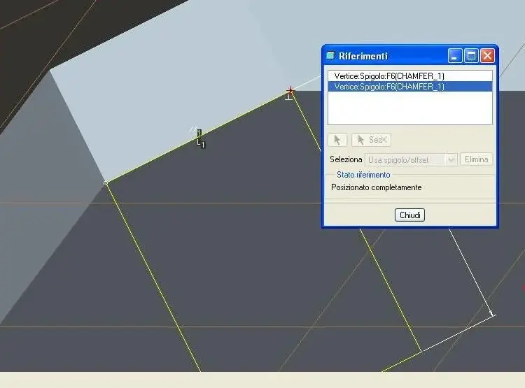

Thank you, but at this point I ask you a further question: When I go to make a sketch in the plan you designed, he asks me some orthogonal references on the floor to be able to place the view. How do I proceed? Do I need to create a further orthogonal reference to the plan in question?
basically as a design in the created plan since I can't position it?
Thank you!
seen so, you can refer 2 points... something like that... then draw your parallelepiped that has a side of the length of the bevel.. .

Thanks p-h! I set the two bevel points as reference and accepted them, thank you very much!
