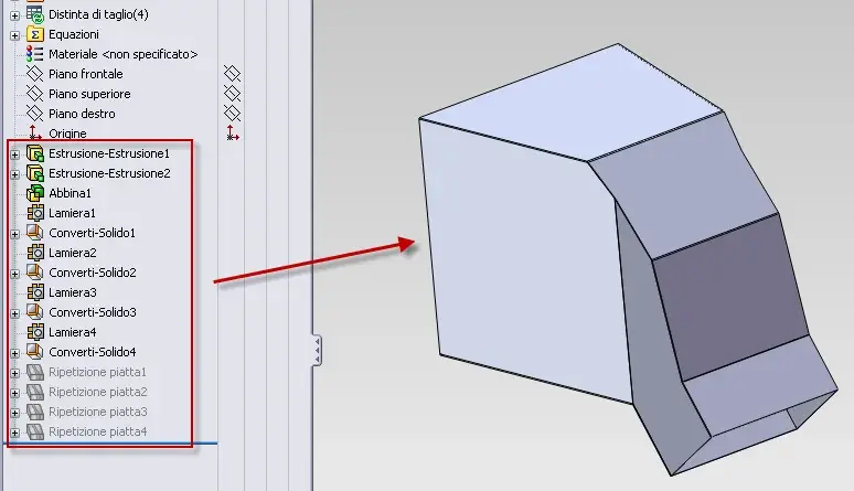

after 2 hours of fight.... .
et voilà....
or...
do not complicate your life with surfaces and thickenings, you think the tool
which you used later to do everything.
from one eye to the quotas (my) of the cutting-extrusion1 :rolleyes:
I've changed the aesthetics a bit.
ps: is the closure in the narrow part desired? the sagomi to the assembly?
in your part, in converts-solid6, take it off keep body.
cation
I do not go into the design of the piece, but I just wanted to suggest a faster and more performing modeling method.
I'm using 2012 so I can't attach anything.
However, I attach an image.

What changes from my model?
take into account that I kept "good" his solid by changing
the cut making it coincide with a edge only for
aesthetics.
I turned into sheet metal.. like you did.

Hi, mike.
Then:
1. I understand your method is very simple, without surfaces are useless steps in less!
2. closing in the narrow part was my mistake....
3. I made the hopper again, because we think that done this way can go better. I wanted to ask you a few questions: Why if I do it using the automatic surface method does the drains in the corners and if instead I do it as you told me it does not?
This other question is more technical on the plates: Shouldn't the sheets in the corners be shaped to fit and weld better? the angle left so will be filled with welding, I do not know the job exactly but it seems a little difficult to keep the plates firm exactly in that position. ...
aesthetics.
the extrusion command and the combined command are more performing than cuts and sweeps.
I just suggested a less complicated modeling strategy and more responsive to changes.
I did two extrusions and used a boolean operation.
I don't want to get into controversy, we've already passed and then I'm accused that I suffer the heat and don't ragiono anymore, but try to use the best strategies during modeling and in the environment together, they improve global performance.
These strategies are felt especially when you start working with bodily assemblies.
That's all.

the corner so it makes you twist and bomb the carter.
I, as a metal constructor, prefer my method, basically make a slight bevel to the sheet creating a v for tig welding.
the edge/pigol only do it from 3 mm up.
Then it always depends on the purpose of the piece, if it is structural, if it has to be airtight, if I have to cure the aesthetic (ac stainless sat. for example).
for your domamde, I answer you lapalissianly. . I think it's the way to work solidworks...:biggrin:

Let's say I understand....
How do I make sheets to cut?
you have to put the bodies on the table (one at a time) by selecting "flat repetition", exposing the dxf or dwg to "work" with the laser cam.
..with sheet metals you can also save in dwg/dxf directly from part 3d model. Starting from the finished bent automatically represents developments in 2d... save by name, choose dwg format and follow the screen instructions.

that is an operation I do for those jobs that will not repeat
and that they are simple to bend, if not I prefer to have the table
with odds and corners, in short, a clear document.
I never recommend rescue on the species side if it contains more bodies.

Yeah, I do that too. in "archive" the table drw with views, quotas, notes and indications for the construction... but if I need to fly the template to send to the cut in that way is soon done and immediately leave the email with the dwg (you do everything in the house, I send to the "cutter" and the notes do not interest him. in our workshop of course we follow the design "real").
and anyway it is good to know that in the program there is that function :biggrin:.
Mar
Moreover saving the dxf from the model is sure to have the profile in scale 1:1, which starting from the table is not always discounted. simply an incorrect option or a view scaled differently to wrong the profile.
I normally create tables and carry them in pdf and dwg for customers (who do not read natives) and then create dxf starting from the model.
