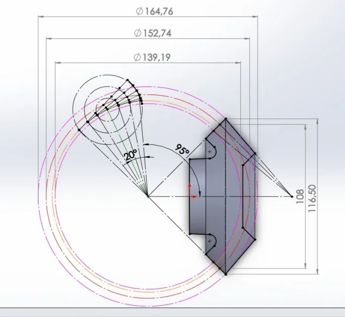

Do you think the creation of the tooth in my video is right?
https://www.youtube.com/watch?v=0s57evlt99gI have seen, that the circles for the construction of the tooth, should start from the conjunction of the perpendicular nets to the tooth
screenshot.9.webpBut, by doing so, increase the diameter... and the toothing gets all high...
the external diameter measures 164.76 instead of 116.5
the primitive diameter measures 152.74 instead of 108
and in the end the tooth results so...wrong
in my video, the center of the circles (rings outside the cone) I designed them starting from 108 and holding the circles head and that of concentric foot to 108 and matching the two points required by the drawing

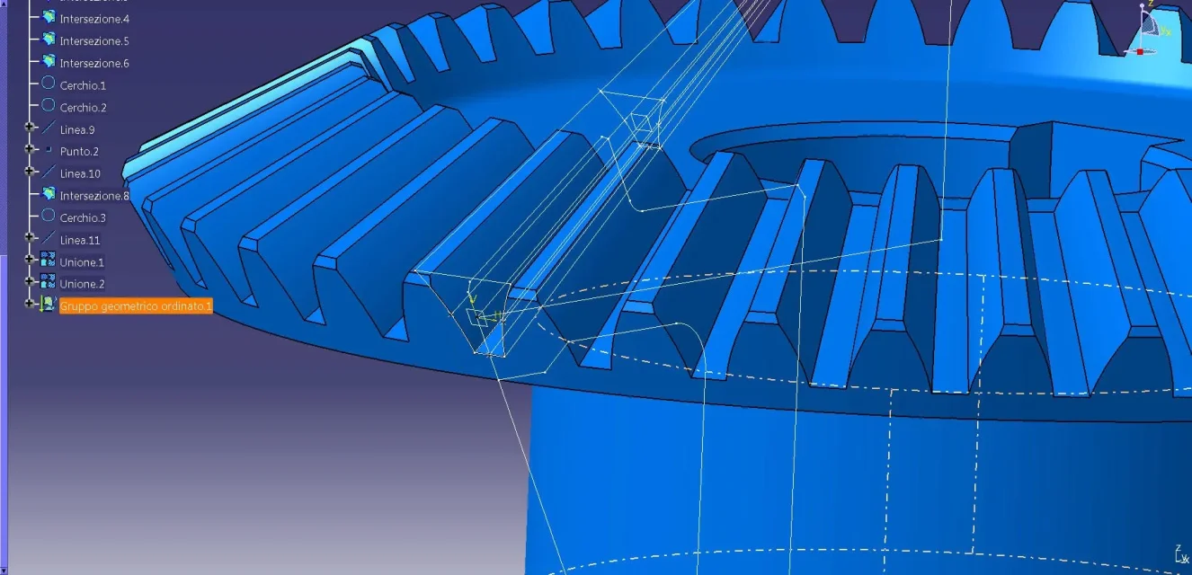

look at this image of how I created the toothed pinion, first creates the tooth compartment with the evolving system.
greetings

I recreated the video with the directions I think right (if they are right) https://youtu.be/12azxgghbsoIf anyone finds mistakes, and warns me, I'd be grateful.
I took a look at the manual that recommended me gianni55
Unfortunately, the only question I have left, is exactly what I needed, I did not understand how to draw the tooth on the tooth wheel.
In the end, I decomposed a conical toothed wheel created automatically by solidworks, and found the data I needed.
from the images of Dorian, for now, I can't understand much.
Hello clatso
I watched the video and big lines it's okay it's logical that the more adoprious points for the more evolved the tooth profile is accurate.
what I did not understand is the 95° line at the beginning when it created the lines at 20° of the pressure angle.
However, the tooth can be created in several ways (I speak with catia) the important point of the evolving.
Thank you!
I designed the evolving starting from 95° instead of 90°, because thus making the tooth point coincident with the primitive diameter, it is already in position for the mirrors (half of the tooth) , otherwise I should have rotated later the figure before the mirroring.
I hope it's logical....... .
the tooth can also be created in several ways, but apart from precision, they must be equal to the end.
Thank you!
Hello clatso
after sending the message I realized why you left from 95° but now the message was gone. the construction is right given the step of 20° six started from 1/4 therefore 5° which is the point of the pressure angle therefore what you have done is correct good year
