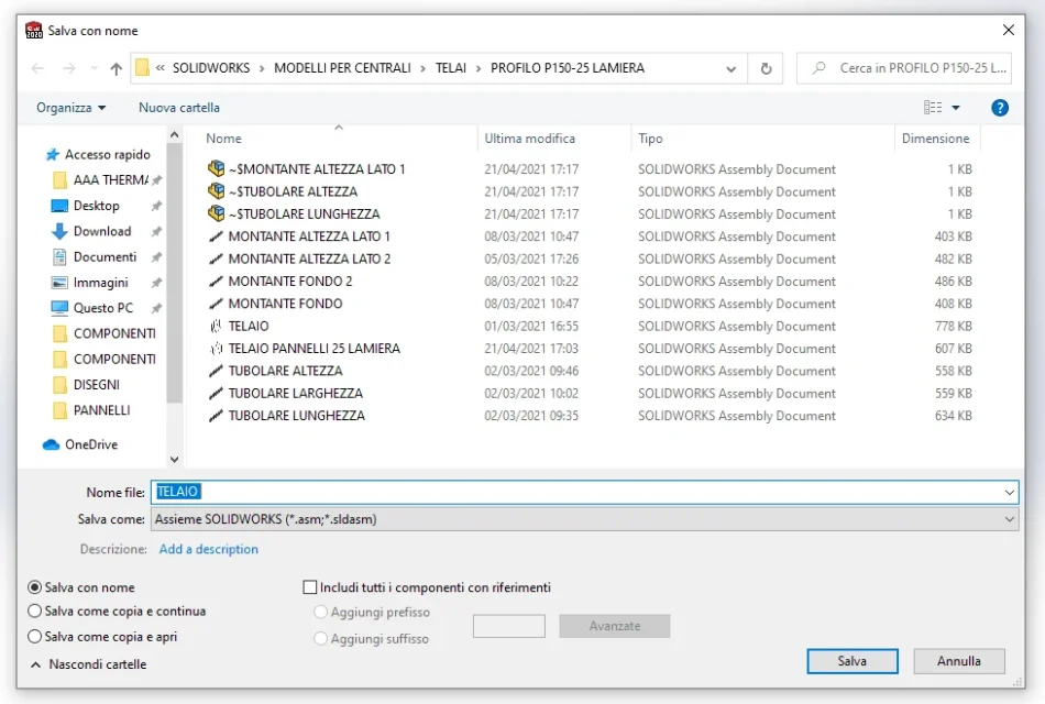

Good morning
I hope you've closed my discussion, I'd like to ask you a little leztion since I realize I'm using bad sw.
I work with axiemi saved in the library I use and resize according to the needs, of course every time I save them with different name on the final folder, so I save with name- rhino- Include all components with advanced references- (photo 1)
then on the save window by name with click references to include virtual components (photo 2)
What do I forget? because cmq the addresses of the parts remain the original ones. .

You need to set up save as a copy when you do such operations. save as a copy is used to create copies completely independent of the original.
