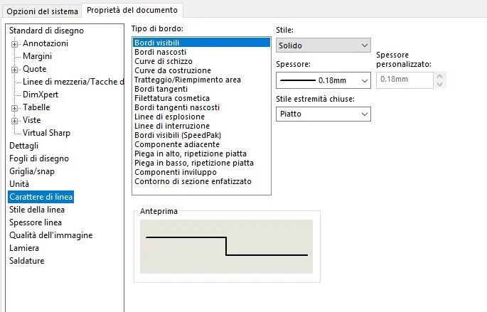

the templates you look for I don't have them x because I have not updated sw. regarding the differentiation of lines in the tables, you can try to change in the options within the properties of the document the character of the lineCattura.webpBut I don't think you can change everything you want.

the templates you look for I don't have them x because I have not updated sw. regarding the differentiation of lines in the tables, you can try to change in the options within the properties of the document the character of the lineView attachment 53956But I don't think you can change everything you want.
then save your design template with custom settings.

sw tangency lines call them visible and not tangent edges, which you can set as you want. test and if it doesn't work feel assistance if you are still in maintenance
but did you set tangency lines with character?
view>visualization> tangent bottles with character
Massive shields, but if you leave visible tangent edges do not take the setting you set in the document options?
Anyway, it's just a little... you exasperate the line type set for the tangent lines and you make two equal views in one with visualization of the visible tangent edges and in a with tangent edges with character
Good morning to all, thanks to Mr. Masses' advice I managed. at the end it was also logical, but remembering all the options is not easy. However I set tangent edges with character, then I set the character I wanted in the table, and eventually I saved the prtdot and drwdot. it works great.
