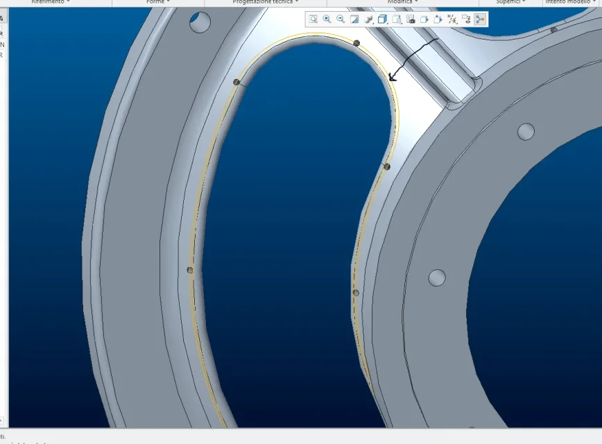

I have to create a hole around the perimeter of the sunshades in the figure, and then put on a closing sheet. someone can recommend me a method.

Do you have to drill on the ribs?, or on the inner walls where the sunbeds are located?
do you have all the features available, or is it an imported?
on the conical wall where the asola is located, you should practically make a 10mm offset around the asola and then place the perpendicular holes to the surface
Unfortunately I cannot post the model
I answer myself, I created a copy of the edge, after which I created a 5mm curve offset and in the initial point and in the middle point, I placed reference points. above these I created holes.
the result is fine, but surely there is a smarter method.
Now you're going to quote it.

in practice what I was about to suggest, let's say you can have more control if you have the features of the slots and you can already create them in sketches.
if you use the feature hole, you have the note on the size of the thread or the diameter, on the 2d you let it out and for the position you manage it all to the 3d file (step or iges), so we know very well that this piece will be inserted in a working center.
Yes, it is very likely that it will end in this way.
