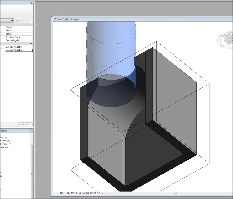

Hi, I have a problem with a barrel once downloaded from the download section of this forum; more precisely I would need to "force it" to make us pass a scale in project, but I can't. I have already tried everything, even with the solids of subtraction of the masses, but nothing to do. Can you tell me how to do this?
Mature
If I don't remember badly, the family on the subject is made by "solids and empties of subtraction". to change it you have to do it directly in the family.
Thank you gfrank, I had imagined such a solution. it becomes impossible to represent it correctly then in the comparison table of the yellow and red, does it?
Mature
to have the situation of comparison you must leave the family in question.
You must create a family based on floor from which the volume of the time is subtracted.
Obviously the floor will be sufficiently thick to allow the subtraction of the volume of the time.
in the model it will be possible to drill the floor, whose intradox corresponds to the time.
Thanks native. I realized it was a dead end. I'll try to follow your advice.
