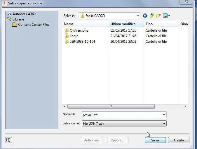

file-save with name-save copy with name-choices dxf.
I didn't exactly look at it there.
Of course that in autodesk they know how to complicate life, you can export to dxf only by saving copy with name but not by export and not even by saving by name. That's brilliant.

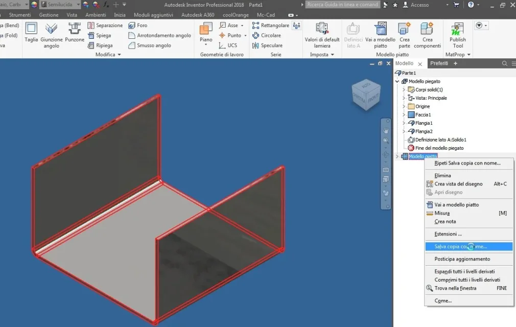

Hello, it is not clear to me, but if you have to export the dxf for a laser matrix, do you have to export only the development of the sheet or all the table idw??? (cartolic rates etc.)

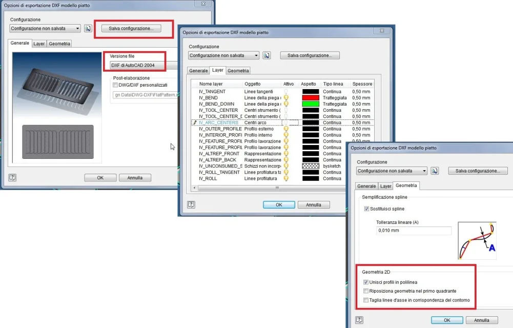

in case you have to export only sheet development, I usually do so:
dxf1.webpselect dxf and save the filedxf2.webpselect the various options (you can then save those choices and call for sucessive configuration)dxf.webpin this way every detail is on its layer and therefore during import into the cam software you can turn off example the fold lines) and the contour is closed in a single polylinea

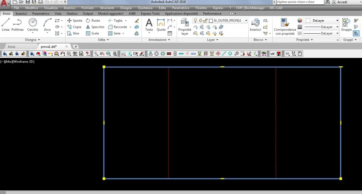

Actually, I was thinking of only creating a 2d design, it's the layout of some tags that we'll have to hack with a laser marker.
I have already created a first part of the layout, but when I sent it to those who will provide us the machine told me that the lines are open and therefore the installed software cannot work them.
Superfast:
when you are on the design of inventor, keyboard command
press: alt > f > c (where the symbol > means: "After prizes" :-)
And it's dxf.
if you want to always save from keyboard:
have fun
