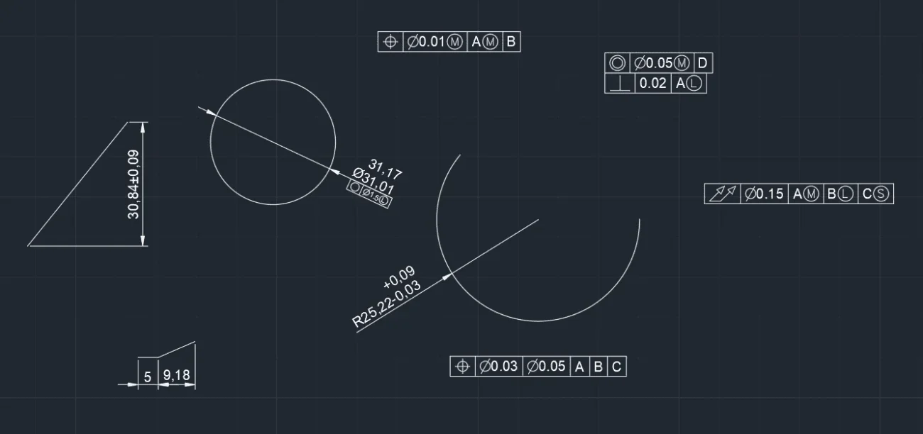

Here I am.
Excuse me, I'm setting up the last things, but having free time is difficult.
here is a complete example with catia.
from the initial design the program automatically gives me the ball and the report.
Obviously, as already said, the report is bland, but customizable.
Thanks for the support for now.
