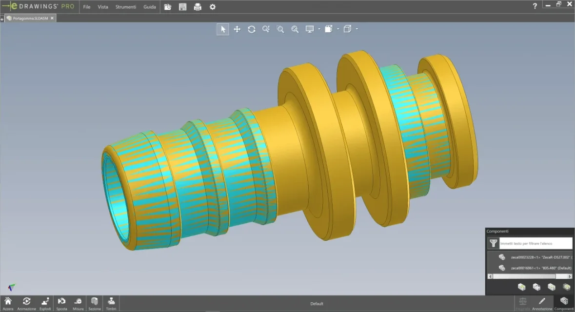

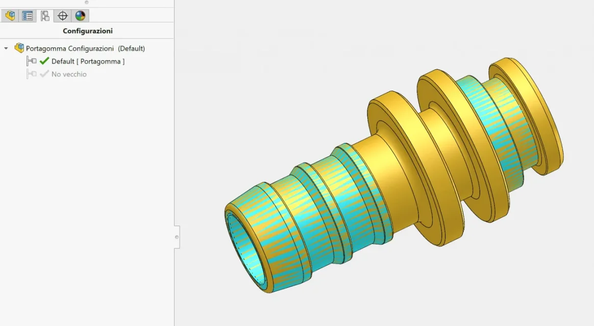

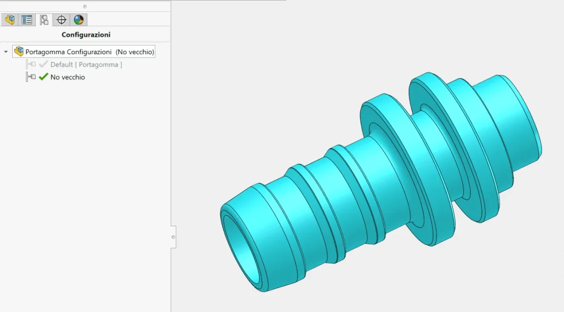

greetings to all I would have a problem that does not solve with edrawing; does not open the configurations... or better always opens the active configuration saved in solidwork (version 2019).
I created both together and part but there is no way to choose the configuration.
01.webp00.webp01.webpEdrawing: 02.webp02.webp
when saving in edrawing should ask for configurations to be saved. read what the guide says
Meanwhile, thanks massive. . .sincerately I never saved in edrawings because having a pdm we opened them directly from there as solidwork files especially tables. then looking for a code with a configuration we found the problem. as soon as I get to the office I try as you recommended, in case we need these files I convert them. I on my pc have the professional that is linked to the solidwork license.
