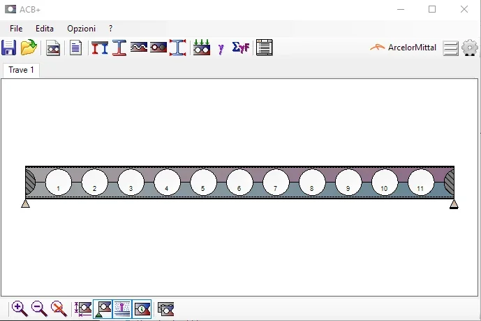

on the site of arcelormittal you will find all the information you need, and also the calculation software:1678204333746.webpthen what to say, well they are beautiful... they use very much architects for large covered areas, fair spaces, airports etc.

I would follow the advice of @ cadinpiedi and I would use the program.
but if you want to enter more specifically: the check to the cutting of the beam is actually the checking of the souls (and automatically check the welds too).
I would add Soul Compression Verification to avoid local instability.
for the calculation of the deformations the moment of inertia will be an average between full and empty tract (maybe weighing it on how much it is full and how empty it is).
you can safely entrust it to the wings.

I repeat, the arcelor software can calculate both single and single beams. keep in mind that it is the same arcelor to perform cutting and welding for project-formed beams, with all warranties of the case.
