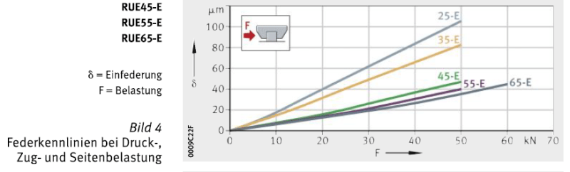

to simulate the contact between skate and guide I would not like to use the "bonded" well something more accurate and take into account the stiffness of 600n/μm that brings me back the manufacturer.

feeling the representative of the skates I see that the guides wander, as linear stiffness, on the 600n/micron. He even told me not to consider flexional stiffness because it makes sense only on very particular applications.
I have now taken the rigidity of the guide and divided it for a contact area, as you say @onda What area did I consider? the spheres have a contact not punctual but little we miss.
I took half the area of the surfaces on which the spheres go. It seems to work.
