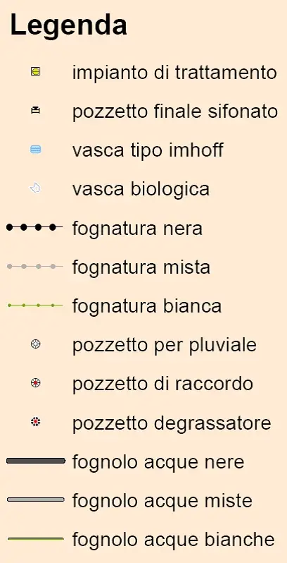

is a collection of notes for sewerage networks, for the design of projects for industrial unloading permissions.
are used as “annotations”>componente>n.mod. for which in plant that in section, are not visible in 3d or in render
are designed to be well seen in scale 1:200. correspond to the legislation in force mandatory for the province of Milan, clearly they are independent from the stairs.
for information:http://www.atoprovinciadimilano.it/autorizzazioniindustriali.aspthe fastest system to insert it (I accept improvements)
open revit (your “project”) on a plant, open also “legend ato” and copy all the page(ctr-c), copy on your “project” (crt-v). check in annota-component (only there you see). then delete all the visible, no longer serves.
I also send you the legend of the symbols published by the ato
