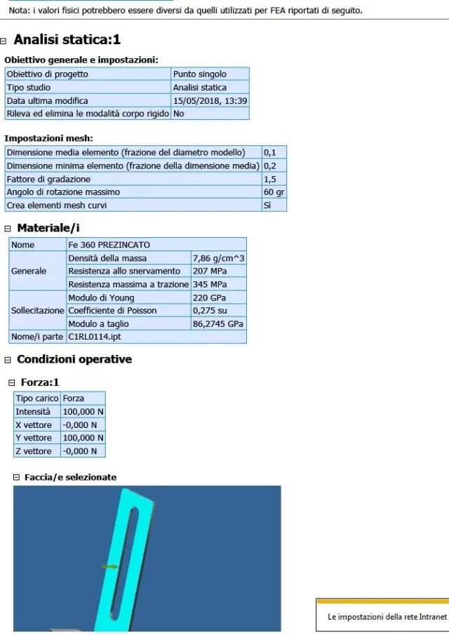

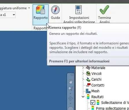

but can you put on the table a study in the environment analysis stress? or can only export images or pdf?
that I know, you can only generate the editable html report later with word_foto__046.webp
