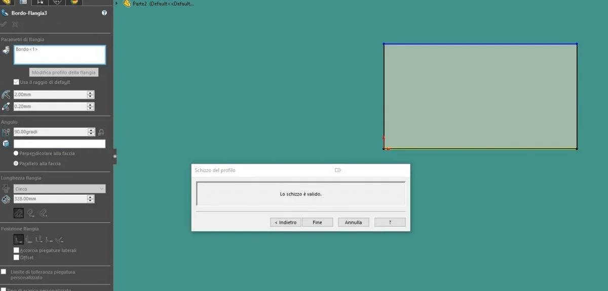

hi, I find the use of equations to change the components in extreme utility sheet both for the first modeled body and for those that differ from it in some sizes so they will be new codes in the same together or in different assemblies. Of course, the code I refer to, alphanumeric, is the code assigned in pdm.
I noticed, however, that, starting from a basic flange tab to which I apply a flange of the edge, if I change the flange profile by intervening the appropriate function activated by the button under the flange parameters box, then I modify the flange geometry, eliminating the geometric relationships and inserting angles and dimensions to the various segments, the values inserted do not appear among the values shown in the table equations therefore to change that geometry
if I do not change the flange of the edge as described above what for me is a problem does not arise.
Am I wrong? Does anyone have any idea how to solve it then see all the parameters that contribute to the modification of the solid sheet ?

those values are not defined in the sketch, but in the function. in fact if you double-click on the function will appear both the angle and the length.
the length is defined by the external line, so to keep it in the equations you do not have to erase it, but possibly turn it into a construction line.
for the corner I would say that it is worth the same, that is, you do not have to delete one of the side lines; But I'm not sure of that.
this as to the fact of seeing the quotas appear in the list of the equtions, anything other is that they are still usable if you twist the geometry of the sketch
hi, your answers made me think of a solution, I made a first summary try and it works: global variables.
experience and public the solution. Hi.
