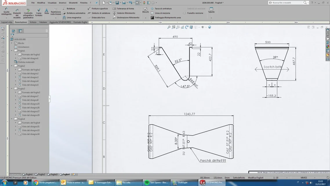

hi to all, during the development of the attached sheet band I find the following development: Where is the calandated part of the sheet the software puts me straight lines really shouldn't be curved?
I also attached the sheet metal step file for those who wanted to open it with a version before my
because the fallen part is on the axis perpendicular to the view. if I had made a curved cut even in another direction (in practice if instead of a straight cut the function cutting-extrusion1 had been a cut in revolution) you could not even get development without making radial cuts of laceration.
try to relax an orange peel without breaking it radially
