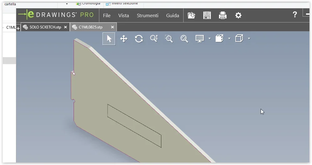

I have no other cad so I tried with the edrawing viewer and it works
whether the scketch is above a 3d model that is only in an ipt1655717869865.webp1655717842433.webp1655717818544.webp
Very strange, I tried a couple of viewers and nothing appears.
I think I've solved it right now. Once I do the sketch, I have to create a surface, for example with "boundary patch". creating a surface then when I go to export it is seen the surface and solve the problem.
I'll try with edrawings to check.
