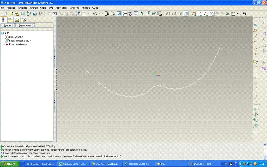

kionn Guest Jul 12, 2010 #1 Hello to all boys I have turned into the forum but I can't find it.. . . I have this file in dwg I want to do the extrusion in pro_e w3 as you do? Attachments PARTICOLARE_b.rar PARTICOLARE_b.rar 24.7 KB · Views: 13

lollone Guest Jul 12, 2010 #5 I saved the dwg in dxf and then imported it in pro-e (insert/shared data/dafile). once set, do the extrusion using the set profile (create an entity from the edge). Attachments aaaa.prt.rar aaaa.prt.rar 308.6 KB · Views: 2

kionn Guest Jul 12, 2010 #6 innocent of your file I cannot import it Lollone as you see from photos I managed to import it but I did not understand how extrusion is done. . Thank you.

lollone Guest Jul 12, 2010 #9 look at this discussionhttp://www.cad3d.it/forum1/showthread.php?t=17128&highlight=profilo
kionn Guest Jul 13, 2010 #11 Please excuse me if I answer so late.... great... thank you very kind as always
