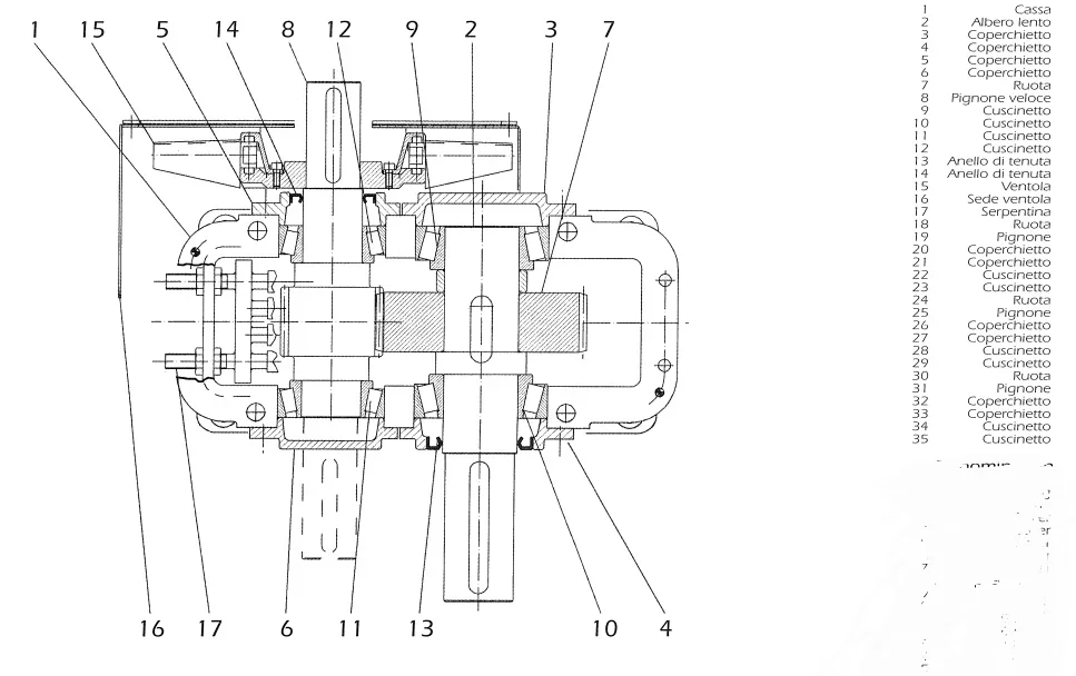

a priori, if I had to do it with no limitation I would do:
single-stage parallel axle reducer and bearings not the conical ones in the figure but I would opt for roller oscillators.

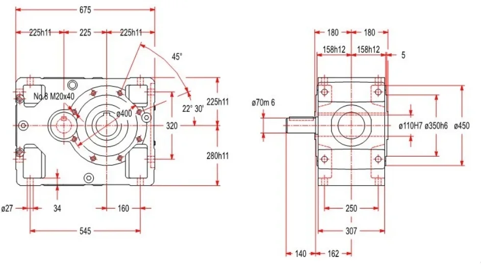

Screenshot_20230925_232421_Samsung Notes.webpthe sue dimensioni sono quest:Screenshot_20230925_232505_Samsung Notes.webpis it worth the project you without adequate experience?
Usually custom design is done when strictly necessary and especially when there is economic feedback vs special application.
just not to go far, red gearboxes with 1,4 service factor... a stage ...
View attachment 69209the sue dimensioni sono quest:View attachment 69210is it worth the project you without adequate experience?

Screenshot_20230926_200038_Chrome.jpga and b why have two gears on the same axis?
what are your comments, feelings etc on the three solutions? What do you see good, bad....better....better?

View attachment 69218a and b why have two gears on the same axis?
