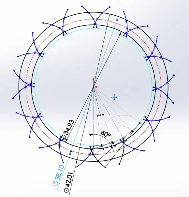

evolved toothed wheel
  • Thread starter Thread starter clatso
the modules defined by regulations are those for which there is all instrumentation, cutting equipment and standardized grinding.
Why would you do something completely "out of standard"?
formulas however apply for any form, standard or invented.
It is a toothed wheel internally where however the module x the number of teeth, gives you the primitive diameter, which is what determines the transmission ratio.
from this diameter remove the module twice and get the inner diameter.
add twice 7/6 of the module, get the bottom diameter.

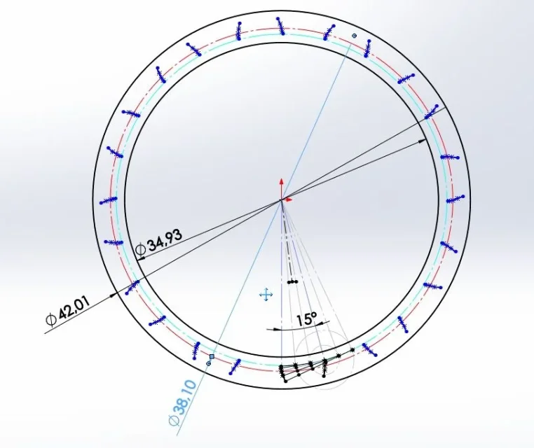

I have seen this discussion now; the design attached by the user does not refer to a toothed wheel with internal toothing, but to the hub of a groove with a profile to asa norms with 12 teeth and a primitive diameter of 1" 1/2, therefore for the sizing it is necessary to refer to the above rules.
exact
