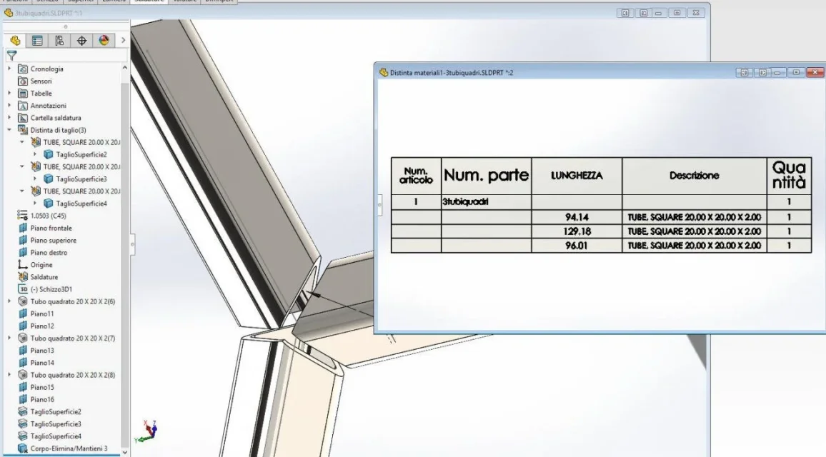

I'm afraid that you don't have the automatic cut of the profiles that was the ultimate goal of the exercise.
If it's for the cut, my method works. but the right method is that of mass, it does not rain!

In this way I'm afraid that you don't have the automatic cutting of profiles
the properties of the structural element, meaning those that are automatically compiled and which are length and angle1, angle2 and total length (from 2016), are created and managed autonomously and automatically detect geometry regardless of the functions that are done on it. if you add a cut the length varies accordingly; if you add material that changes the angle of one of the ends this property will change.
just a little to verify it: make a framework structural element 100 long, on one of the side faces drawn a triangle, quote the catetus and the corner, extrude it to the opposite surface and put the tick to join result; in the properties you will see that they will be changed compared to before
