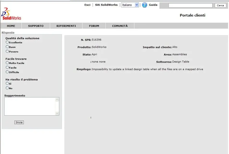

...so cippa... I am in swx 2011 prof sp.3 x64 on w7 x64 excel 2007 (but I also tried with excel2010)... and continues to incarnate... :
in the reassignment of the paths, I have inserted paths unc.
without wanting to miss us so much, I suggest you try using unc paths, because, regardless of the bug or not on the mapped paths, you would unleash any different network mappings between users.
I am also using all the latest software available (solidworks, windows and office), so I don't know if any problems have been solved with the latest versions.
So, to check this out, you could get a virtual machine and check if everything is resolved and then decide whether to update or not.
communication for reggioyesterday I tried to make a small set commanded by external tebella as you say, with the various parts always with external tables and a general table to connect the data to the various pieces.
I didn't find any problem.
network work with mapped disk, on server
win server 2008 sp 1
pc so win 7 64
solidworks 2011 64 sp 3
office 2007 32
can it be that you have various rights and robes problems?

sì... win e office aggiornati su locale e su server ... :frown:
rights problems no....
tomorrow I contact those who follow the network to understand what is mapping and whether we are "mappati" or not...

Then maybe I managed to replicate your problem.
This comes when you click dx on the table and save table.
I also behave exactly as you see in your video above.
I didn't realize it because I use another system.
Anyway the thing I think you solve it by "modifying the table in a new window" this is opened in excel and here you save it by name, which I don't have problems, give the name you like.
at this point close the table and return to solidworks.
go to the table button dx change function and connect to the saved file first and everything should work.
