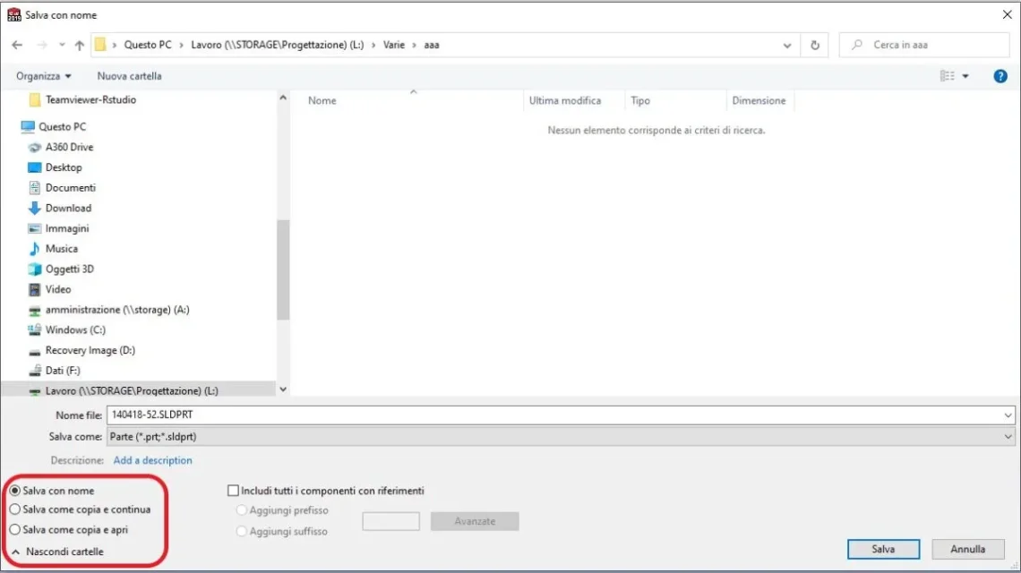

I connect to the discussion, when I save by name on parts created internally to the assembly, I do not replace them automatically, I must go to replace them by hand later.
Surely there is an option to check out because my colleague saves this and replaces it does, you know politely what the option to check?

when you save by name you have 3 selectable options with a flag:
1-Save with name: create the new file and replace in the axieme
2-Save as copy and continue: save a copy and not replace
3-Save as a copy and open: save a copy and open it without replacing it in the axieme.

perfect,
thank you so much was what I was looking for, working with the small window and these flags didn't really see them.
