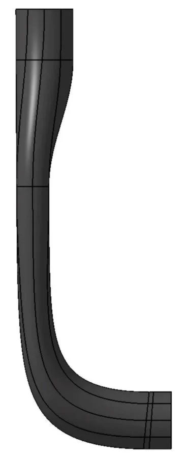

I apologize in advance for my ignorance but I am now facing the surfaces in cativa v5.
I'm trying to replicate a model of a very irregular plastic tube and I came across explicit plans.
looking in the plan creation menu does not appear to me this option and I do not know how to replicate them.
I wanted to ask you if someone can explain to me how to do it and what are the benefits they bring.

I confirm that the plan icon has lightning as you say and is not editable.
after the message I tried to replicate the tree of the starting file without these plans and I managed to complete the model, so you're right when you say it's just a reference.
is an aspiration tube of a boiler that passes through various components so it tightens a lot in the middle section and has two non-axial exits with round section.
I wrote very irregular but perhaps only for me that I am accustomed to very geometric shapes. ?
