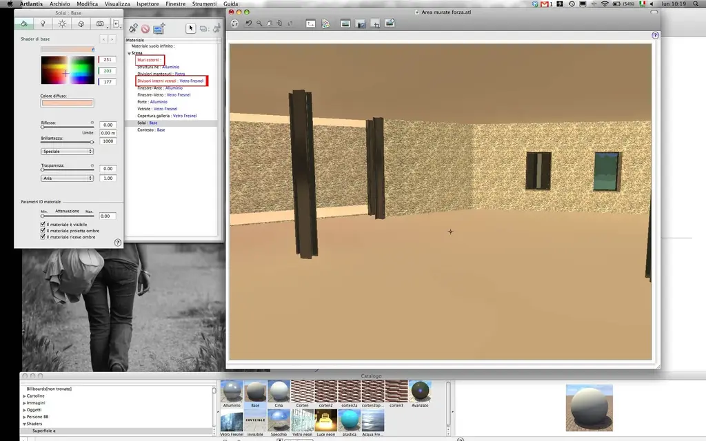

I tried to export with vw on artlantis: I have problems with the walls. I have made two types of custom-style masonry and artlantis I care about the classes without I can use them. I also noticed that in the shader list it marks them in red. What can I do?

according to him those classes are empty. verify in vw that you have correctly assigned the walls to those classes.

Can you take a look at this?
