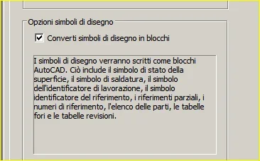

exporting an idw in dwg, all lines of sections are exported as a block called "sezioneconv2d0" and so on how many are in the table.
I ask you and can make sure that the line is exported with a block name I decide?? ?
Or export it as an explosive geometry? ? ?
Too much from options in export, the check on the choice of blocks does not include the section line
I don't understand eugenesis...even if you remove the flag...the lines you section remain blocks.. . are not managed by that flag
You have restarted between one operation and the other, if it acts on the register, it is not said that the thing is simultaneous!
you are right, they are and remain blocks .. will be a choice of developers ..
