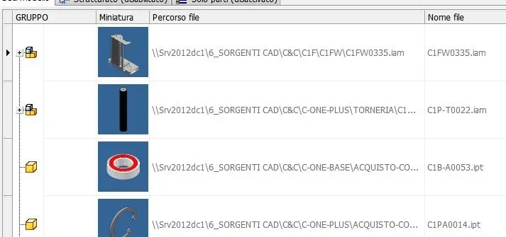

I would like to extract through vb or ilogic from a set the file name and path of the components that make it,
extracted data then I can save it in a text file or an excel file
I tried to export the distinct components by activating the file path column, but it only exports me the name and not the path
I do not care about other data type quantity or name part
thanks to all
with distinct if you activate "file path" and possibly "filename" you should solve
with ilogic is a little more complex since, you have to "cycle" inside the tree of the parts
