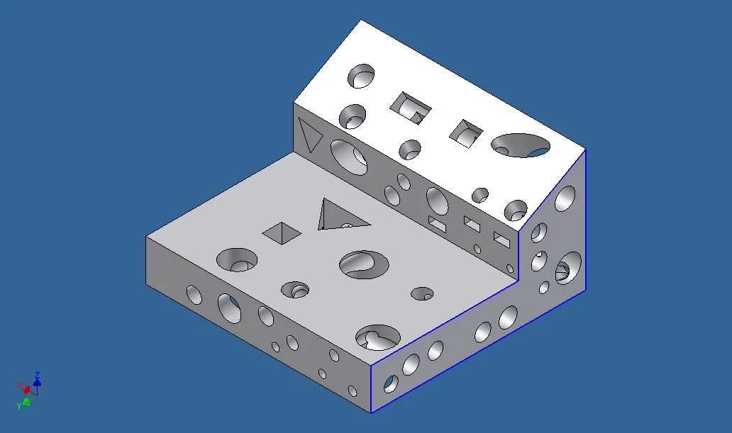

Part1.webphello to all,I looked for from everywhere and not only in the forum cad3d, but I did not
found an answer to my problem using inventor 2010.
I would like to draw (or model) the attached piece and proceed as follows:
1-Disname the profile highlighted in blue and extrude it
2-design on each face a sketch consisting of various profiles
3-extrude each sketch (in subtraction) by selecting profile
the problem is when I have a hundred profiles inside the sketch to extrude
in subtraction on each face:I should select profile by profile and if I mistake
select I remake everything from top.
how would you proceed?
there is some alternative method to select multiple profiles inside the sketch to
can extrude them at once?

Thanks peppe for the answer, but maybe I explained badly.
I pose the problem in another way:
try to make an extrusion of a simple rectangle, draw on a face a sketch with multiple profiles (about fifty circles),
to extrude these circles by subtracting them to the solid as you would? You will select the circles one by one true?it's here my problem I wanted to know if there was another method to select all the circles at once because if not, it is really the thing is terrible.

thanks rf.infissi for your clarification,
you are right with regard to a regular cube or solid, but if you try to make the same reasoning for an irregular solid like the one attached above, when you do the extrusion with intersection you cut the rest of the solid, and then remake the extrusion of the cut parts with condivid sketch or make independent solids do the extrusions with interseca and eventually join the whole, it is where I arrived to solve the problem

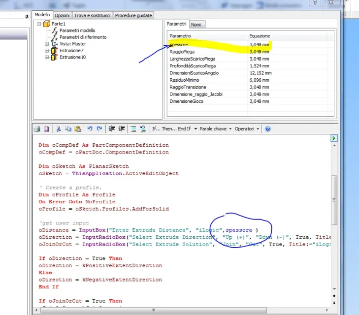

Maybe I found a solution to your problem
follow the collhttp://inventortrenches.blogspot.it/2012/03/ilogic-to-select-all-of-closed-profiles.html?m=1is an ilogic rule that selects all closed profiles of a sketch at once and performs extrusion or cutting.
I didn't try but it should work.
As soon as I have a little time I try
