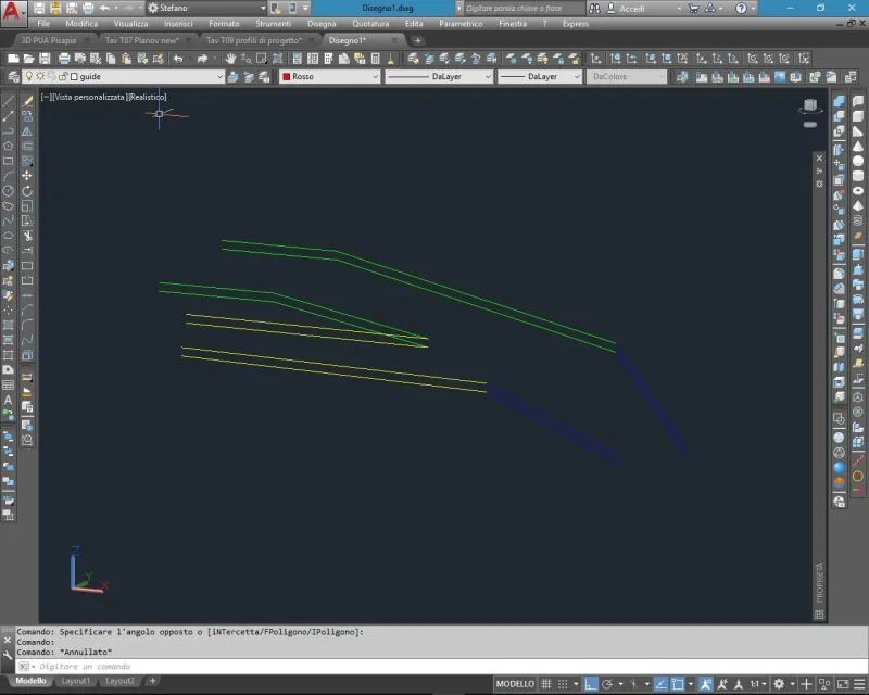

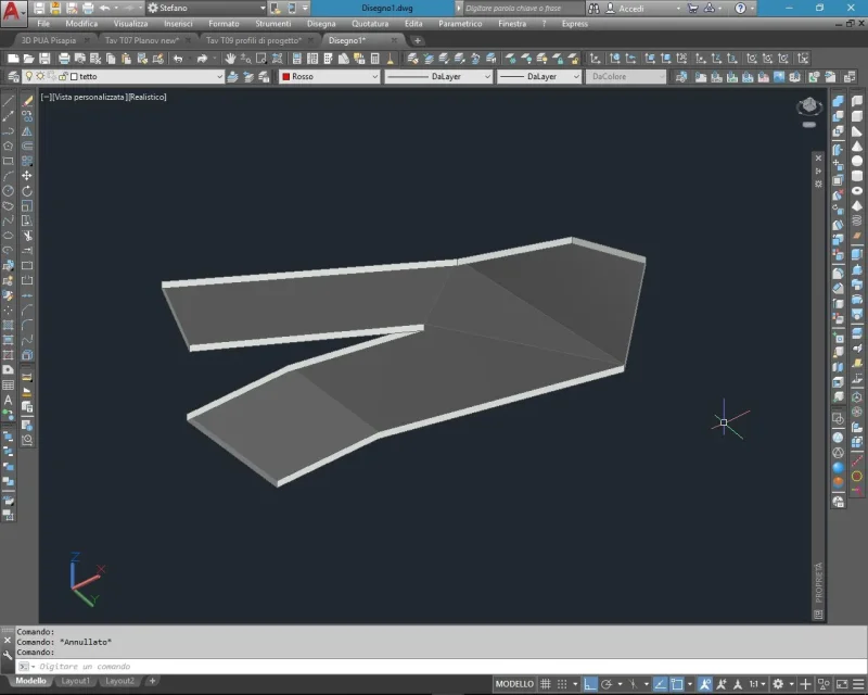

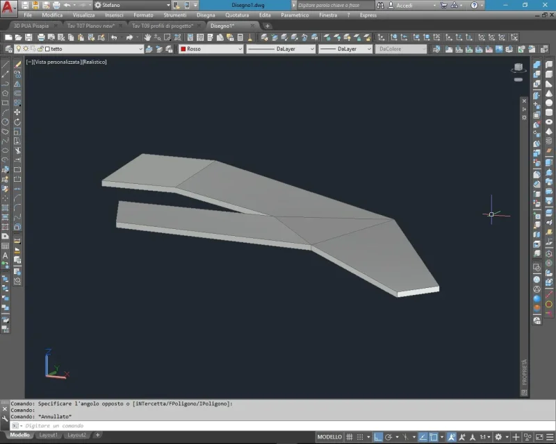

problem solved with 3d polylines and loft command.
in the end most likely you will not get a solid but of the surfaces that closing them suitably will take the look of a solid
procedure:
