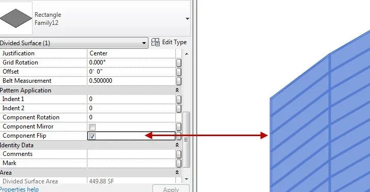

I don't think it's possible as a façade system, but as a model lowered family on a split surface, and using the "flip" option, so:
