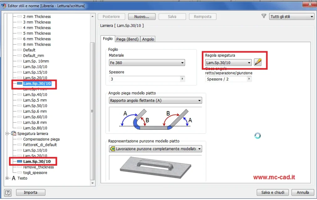

hi, small question , I looked in the group but in vain or at least I do not find the answer, I want to create for individual sheet thicknesses of different styles (15/10-20/10 etc) I do it but when I recall the desired thickness the factor k is never what I associated with the thickness but the last created where I am wrong?
you need to create different rules for the k factor based on the thickness you want to manage, and then associate them to the thickness rule1598693025370.webpso that, when changing the rule, also various the associated k factor1598693106636.webp
