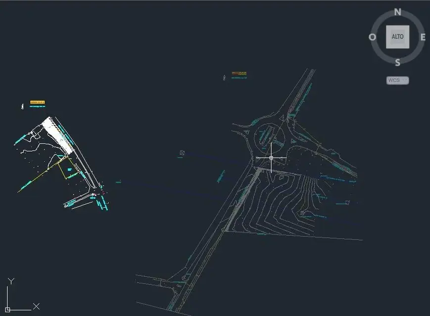

I don't understand, I finally use the 2011 autocad version in the office, but unlike the old version of the 2009 autocad, we can't understand why when you upload a reference the color is faded, it seems almost transparent. What do you have to do? is it a default setting that loads reference like this??? ? in other older versions of the autocad charged a reference and saw it with the features and colors as if it was an open design normally. ....

is a desired effect to differentiate the current design from the external reference.
with the xdwgfadectl variable you can manage the fade, putting it to <0> you will no longer distinguish the xrif from the current design.
