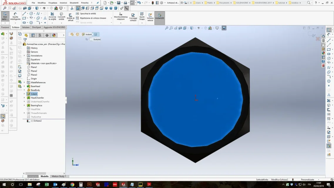

I find myself having a problem never happened with toolbox.
the environment is windows 7 64 bit, sw2015 professional...rolled and weird rode. never had a problem.
in practice the hexagon of the recessed screws is not centered (the quotas are not updated by equation!).
Allego captures video explanatory.
Did any of you have such problems?
if you, how can you solve it?
Thank you so much!

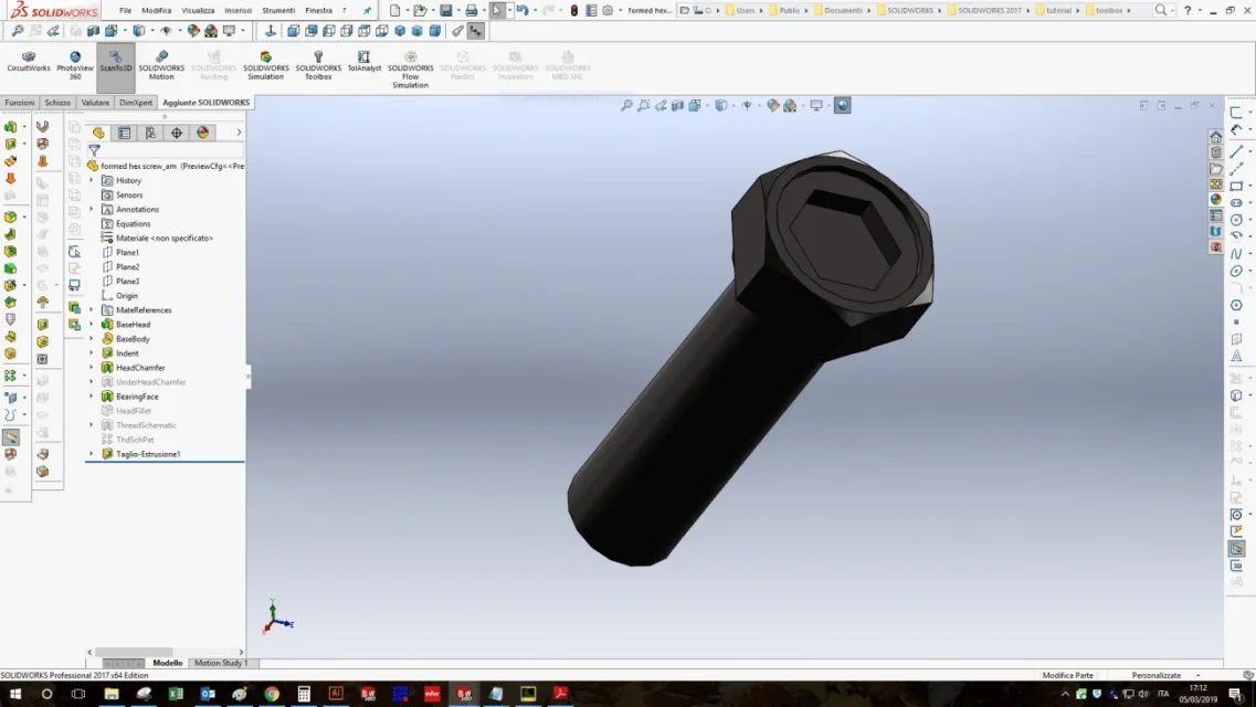

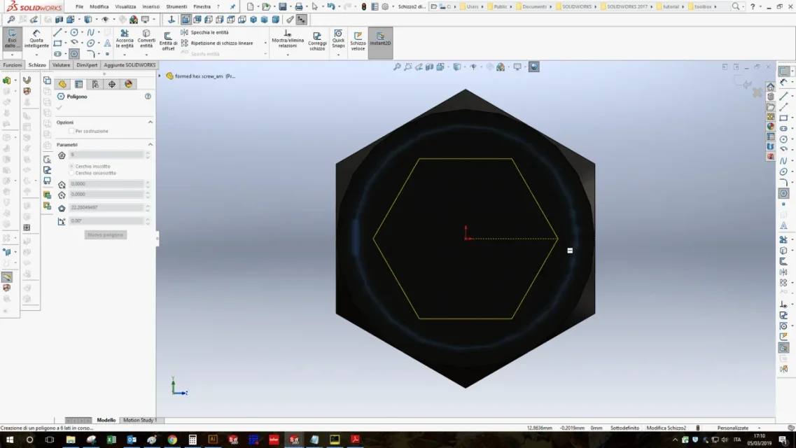

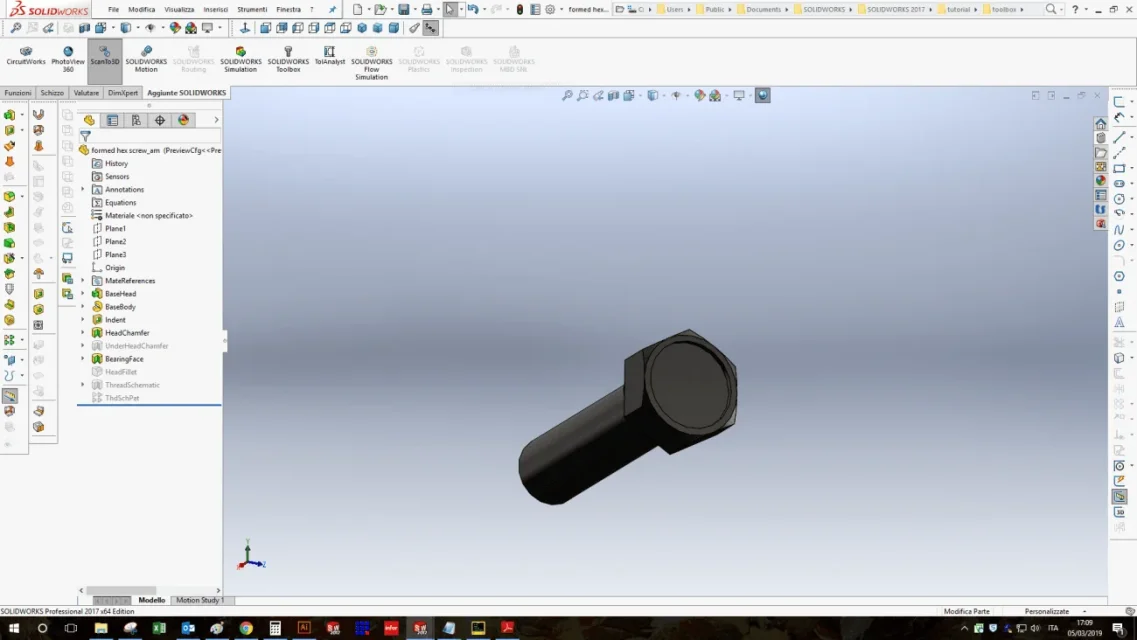

1.webp2.webp3.webp4.webpI wish I could even post the file but unfortunately I use sw2017 so I don't think you open it
I looked at a toolbox screw with hexagonal seat and confirm my idea that the tollboxes suck
the vine that I opened, an iso 4762, has the sketch of the underdefinite hexagon (and already here we are put wrong), then it is those quotas guided by equations serve to define the hexagon to say that the distance between the centrpo and one side is destination of the width of the quarry (it is necessary to be geniuses to think it) with the result that they have equations that they do not serve a worthy cippa if not weighted.
