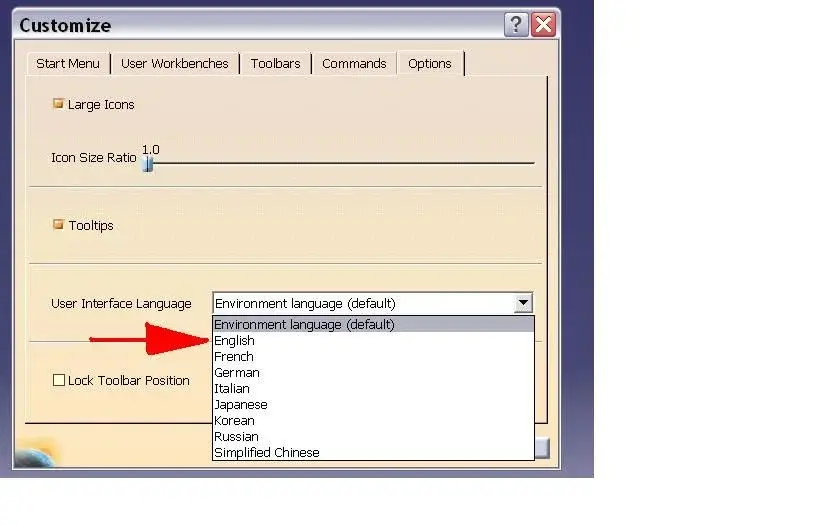

excuse my impediment, but I have a version in Italian of catia, could you send me a picture of what I have to select to do a surface analysis?
tools/customize that in Italian plays as tools/personality (google translator source, http: //translate.google.it/#en '%t') and then see attached image.
(boundary = edge, source barlafus)
once put in English it will be easier to follow the advice of robcrac
enjoyment
