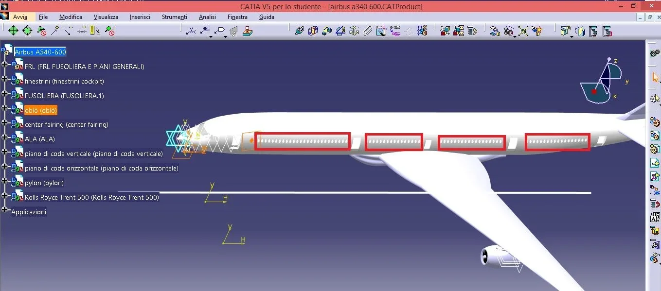

save the problem is simple (it is done to say :wink: ) : top down modeling of a set
1) Having 2 external products and references,how can I create a duplicate translated on the chosen external reference plane? (hjo tried to apply me with the master and mirror command but I am not able to find the right procedure alone)
2) Having 1 product to be repeated several times, can you create a repeat through n matrices of this product that are independent of each other? "playing" with the matrix command I can create the first repetition, but when I try to generate the second matrix it recognizes me as an element to repeat the entire matrix previously created) if this is not possible that solution you propose?
2)nuovadomanda2.webpand good Christmas to all:redface:
1) from the icons present in the product, it seems that you have generated some discrepancies of definition that are own of the mode of design "contextual parts" that obey rules that I know little for having used them even less... in practice you did not use the classic insert part existing in the product.
If I was in front of a product with simple parts, I would tell you to create a part that contains the wireframes necessary for the positioning of the engines and fakings (typically the axes and reference plans) and to insert in the product many existing parts as you need and place them with the constraints. with contextual parts may not be so simple and immediate.
2) if you have created the openings for the portholes in the fuselage catpart, by means of a matrix, you reuse it in the product to place all the portholes:
positions the first porthole, then with the reuse matrice command they automatically position all others, this always within a simple part and not of a definition anniversary
