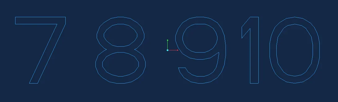

Hello everyone,
I tried to do a search in the forum and on google but did not find solution to my question: How can you do a part with a progressive number that changes according to a family table?
what I would like to get is a part where I can decide from which number to start and have a tot of consecutive numbers later.
as in the attached image.
thanks and good day

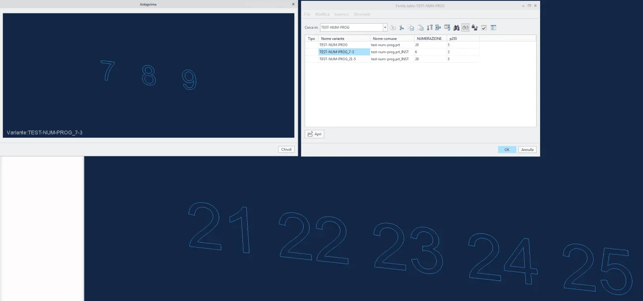

I tried to use the numbering report=numeration+1 but the family table does not hold "in memory" the first number I entered. For example 7, the family table holds the last number of regeneration and would still miss the next part.
I try to explain it another way
(in the family table)
instance-1: "numbering" = 7 - (column for increasing the number) = 3
result:numerazione-1.webpinstance-2: "numbering" = 21 - (column for increasing the number) = 5
result:numerazione-2.webpI don't know if you can insert the consecutive numbers in the same sketch or you will have to make a series of a number with its increment

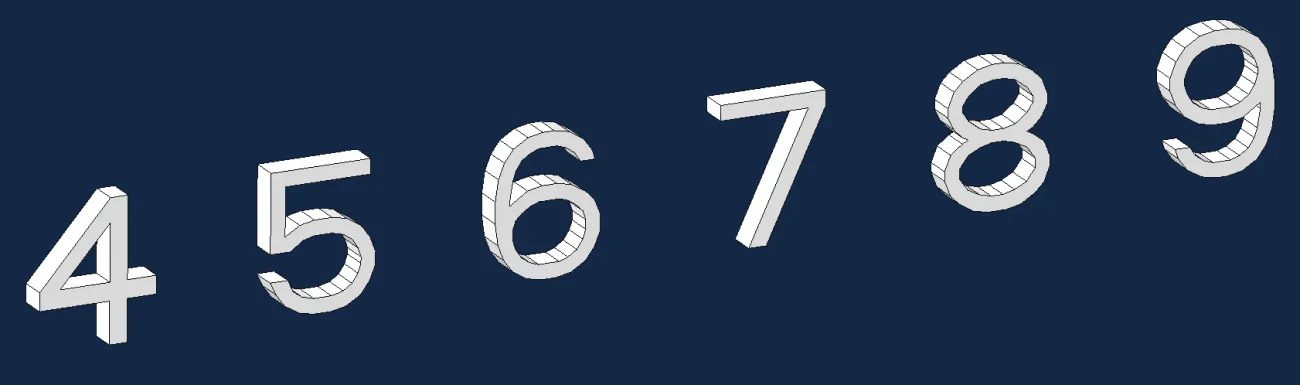

in practice the point that has created in the first group of features, serves for the increase of the number (in fact it is 1 at the beginning and if you activate the points, create a series as well) with a feature of measurement you get the incremental value (so never "+1", but "+1", then "+2, then "+3" etc. just to avoid the infinite regenerations), increasing the distance of the point to the distance of the scketch, goes to increase the number.
in the series, there are more inglobed quotas, not only one for each direction
difficult to get there, but it seems functional.
However, this cannot be done automatically on the family table, individual elements must be created.
I managed to create the series with the growing numbering commanded by family table1538125000275.webpNow I will have to find out how to change the height of the character and the space between the numbers depending on the size of the number itself.
in order to bind them to a well defined space
ps: I finally used the first video method of the community
