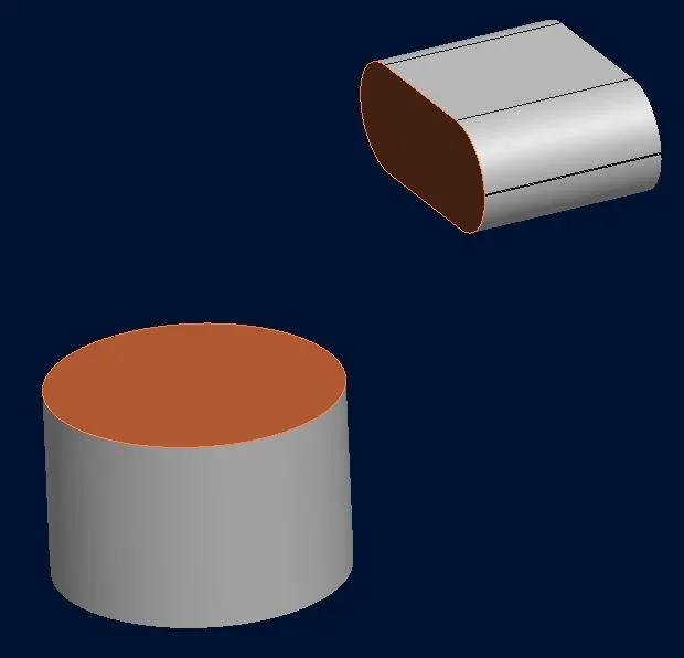

hi, I would need to combine these 2 features with an intermediate curve feature but I can't even if I've already done it a year ago. Give me a couple of straights? is the blend to use right?a.webp

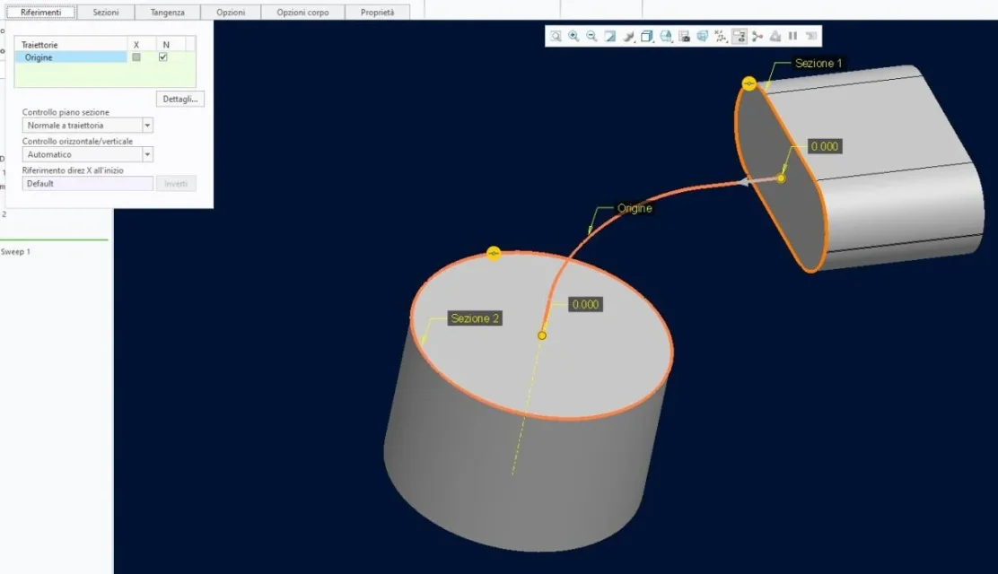

I did the trajectory, I gave him the starting and arrival section but I did not form.. .b.webpc.webp
sketches must be composed by the same number of pieces.
be careful to put the start point properly otherwise it is rolled up.
Great! the same number of pieces I forgot and I managed as you see. But as you had anticipated, I get rolled out and I can't change the starting points.c.webp
go to the sketch point where there is the arrow, if you click on the reverse or choose the point where you want to start the sketch and click on it and type in the window that opens the start point.
