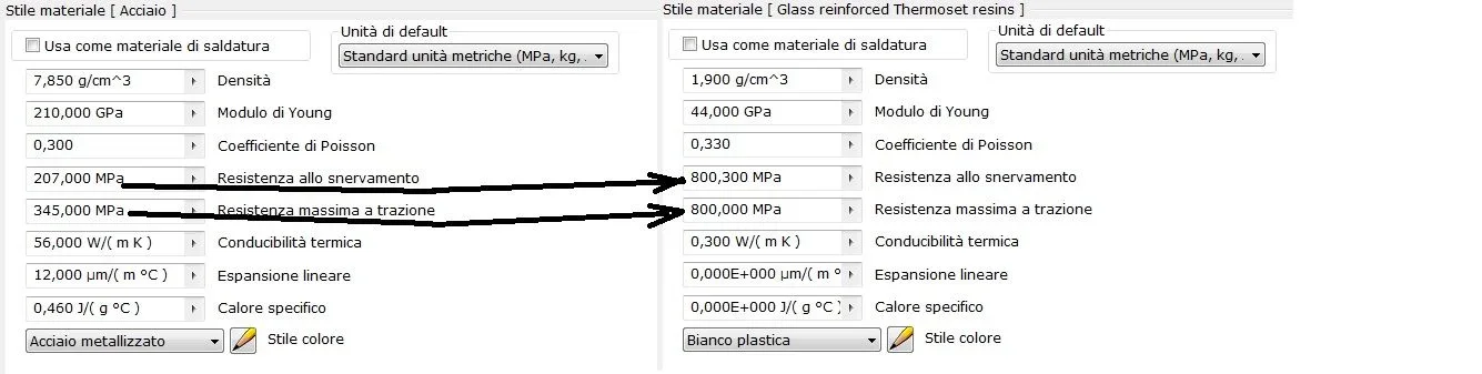

I created a new material (plastic covered with woven filament)
in publisher styles and standards. inserting the values of the material that requires inventor.
Confronto materiali.webpit is possible to slice a plastic tubular inserting as

My problem, indeed no, my question is this. you can set inventor in a way
that requires other values of the material and not those that ask? for example I have the following values
can you set these and not those required by inventor?View attachment 378
- - - updated - - - -some data are common, such as density etc... But others differ.
Thanks again!!!

I created a plastic material. I set the fixed data that inventor requires, such as: density, maximum tensile strength, yield resistance, etc...
I had performed a first analysis but it is not true in the sense that, the material created is suitable for traction uses thanks to its high tensile strength; but it is not suitable for uses that provide flexo-torsional efforts. I'm going for an example.
I created a loading platform for an electric vehicle. This floor consists of the tubular of the plastic material I created. I loaded it with a remote force of 6000n (about 600 kg distributed on the surface of the floor. I tried to break it and I got that the floor doesn't feel a bit of effort! I would have liked to add other values to the fem as the traction reistency (senso: transverse) compression resistance (transverse) flexural moduls (transverse) etc...
to get perhaps a more truthful value, as the plastic material I created I am sure that would not resist the above use I wrote (of the dish) as the structure would be loaded to flexional forces and not traction forces. I will now try to compare the results both with tubular plastic material and with tubular steel to verify the calculations. thanks to everyone for the interest!

the fem module of inventor is something entry level, which helps a lot in the preliminary phase, when you have to choose sections and/or materials (typically metallic) but not much more; but above all it is necessary to emphasize that this fem does only linear analysis, so it offers reliable results only if the analysis is made on isotropic materials.
to do analysis on anisotropic materials, you need evolved sw and from what I understand, the plastic tubular you want to analyze is made with an anisotropic material, therefore it is useless that you seek comfort from the fem module present in inventor.
