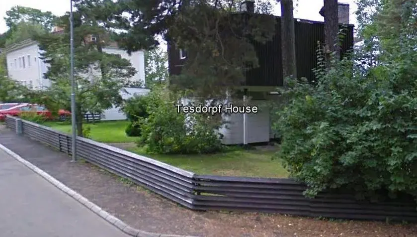

hi to all, having to reproduce the fence in the enclosed photo I was wondering if the most practical thing to do is an extrusion on path (which I never tried to make directly in the model but only in the family editor) or a railing.
in the latter case should I create a family of panels balustrades? I tried to create a railing profile made as in the second image, but I couldn't load it. . .
as you can see the fence has rear mounts and the profile is continuous, except for the points in which it makes a right angle and ends on rectangles.
thanks in advance for the advice.
