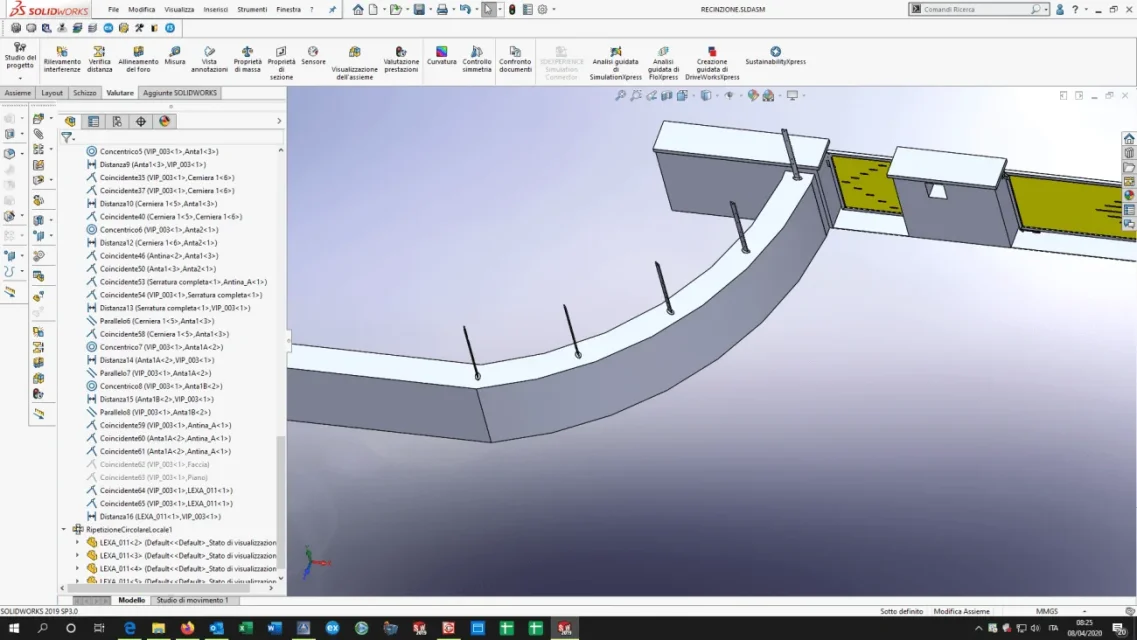

Good morning to all, someone can give me a hand to pass perfectly in the center you have foreheads that are in a radiated perimeter. as you can see from the photo. Thank you.

Sorry if I wasn't clear, I should go inside the holes of 12.5 mm which are in the plates of 8 mm thick with a round d. 12 mm, clearly in axis to the radius of the wall you see.
So what? What's the problem, drawing the 12 tondino?
draw the tondino that has as constraint the passage in the center of each equal stake, thus increasing the diameter of the tondino or moving the hole, the system design without having problems.
draw the part in the environment together by binding the trajectory to the holes.
then you can do the round as sweep or as structural element
