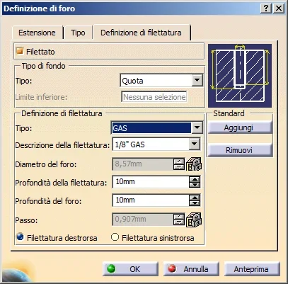

who is interested can download free from here bit.ly/catia-v5-gas-thread a compressed 7z file with inside an executable that creates the following folders tlwxpn\catia\gas in documents.
inside the gas folder you will find:
- the gas.txt configuration file,
- a pdf with iso228/1 gas threads,
- the gas_readme.html explanation file,
- the possibility to uninstall everything.
the gas.txt file must be copied to the standard folder of the catia, if you have not changed it:c:\program files\dassault systemes\b21\win_b64\reffiles\standardthe example refers to a v5r21 environment windows7 64 bit.
generally to copy the file you must be the administrator of the machine or have a user with administrator rights.
if everything went well this is what you will find in the thread panel
the correct size of the hole, for example 3/4" gas, will be inserted automatically during the quotation.
that's all folks!!!
