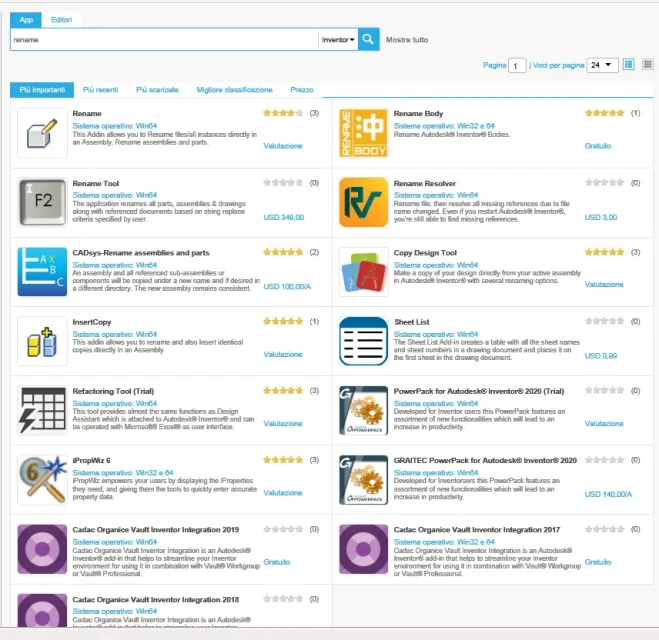

check if you find something cheap in the app
https://apps.autodesk.com/invntor/i...invntor&facet=&collection=&sort=&query=rename

I already use a software for automatic renomenclature, the problem is that often happens that rename the file then the name of the part, inside inventor, does not change:confused:.

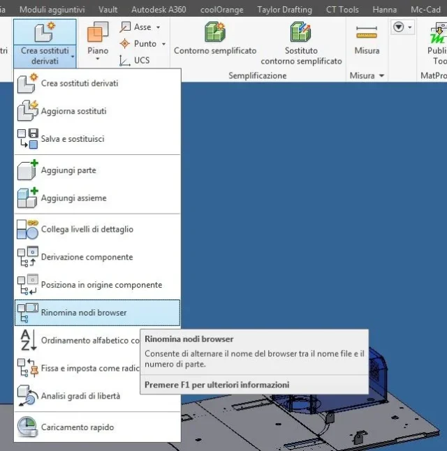

for the rename of the browser, you can use the appropriate command
I do not remember if it also updates the property of the part number,
However I attach an ilogic file that, if launched by the main axieme, updates the number part with the file name without extensionrinomina.webp

matteo hats work great the "rename browser". you solved me a nice problem (and you intrigued me with the ilogic file that I will try as soon as I have more time).
