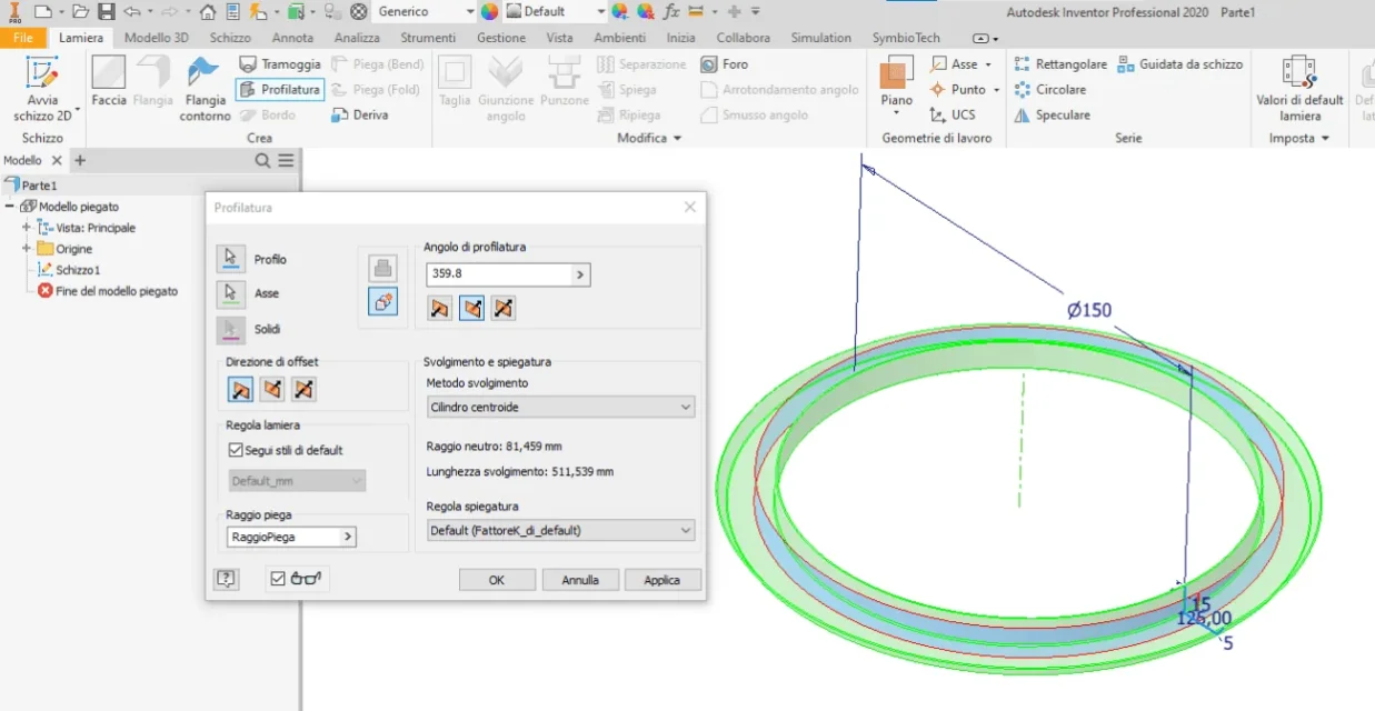

Good morning
I would have thought of the ifeatures, but I can't handle it. The alternative is a brutal revolution but comes out of the plates. . .
greetings
Hello.
to make it simple you could use the profiling command, which allows to generate a solid of sheet "revoluting" the profile drawn around a board being able to manage the options that then affect the performance.1599387170359.webp
Hello.
to make it simple you could use the profiling command, which allows to generate a solid of sheet "revoluting" the profile drawn around a board being able to manage the options that then affect the performance.View attachment 59221
Thank you very much
I thought there was a way to make it more realistic with a punch, to test the operation but I think it takes a more specific software
