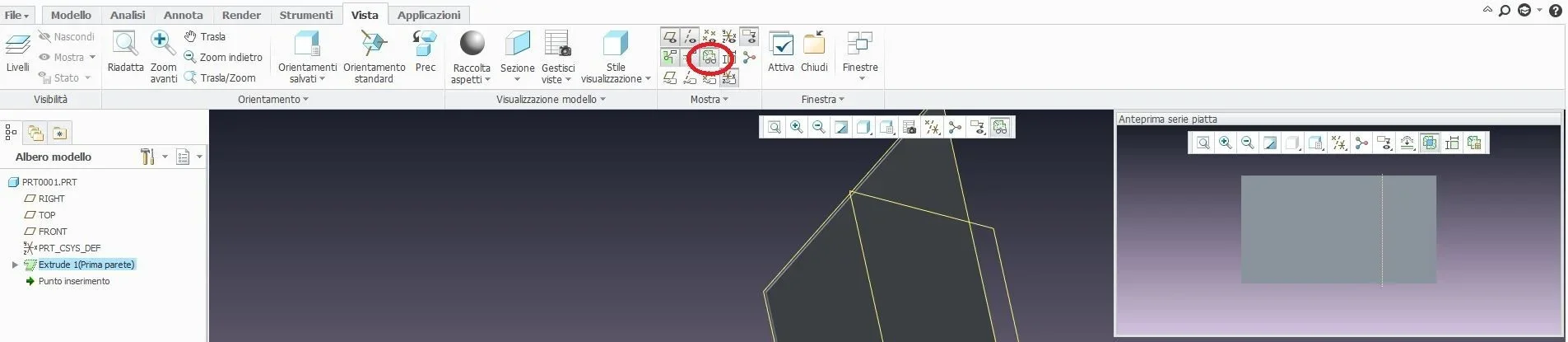

Hello everyone,
I press that I am not very experienced in creo and in particular in the drawing industry,
I find myself having to put on the table a view of sheet development, only that I have no idea how to proceed.
thank you in advance for the answers given

hi deep70, for the development of the plates in the table usually there are two roads:
- Once you have designed your component in the sheet, select the "plug" command and then realize a family table where in the variant you go to activate the created feature. in drawing, in addition to the views of the finished component, go to insert a new model that is your flat plate(developed).
- via the "flat series" command, but I use it little
greetings and good work

for the family, you must insert the flattening feature and select "no" in the line of the instance that will be the development.
"flat series" (or "top series" for previous versions of the creo), is faster as execution.

after running the command "flat series" the part remains only flat in the darwing.. while I would like the three classic views is the flat view or in development dir turns. .
faster because there is the special command, while the flat series with relative family, you have to do it by hand.
in the table, you must insert the flat series model, not from the model still bent.
then on the menu views -> insert model -> select the sheet again and the system proposes you, if to insert the folded model or the flat series between the variants of family table.
on menu view -> preview series flat -> on the shutter that appears "crea variant".

I have exactly that menu, but what I wanted to understand is:
Can I enter the development view on the same table where I also have the other views of the classic quotes? or do I have to have two separate tables?
Yes, as mentioned above, in 2d:
design->adjusting the sheet again, the system proposes the choice between the folded sheet and the "_flat1" (which would be the flat series), selections the latter, from here when entering the views, will be the development.
but where do I find - design models > add>... at the beginning the system gives me the possibility to choose the flat, but once I do what I do to insert the normal views? or vice versa.. .
