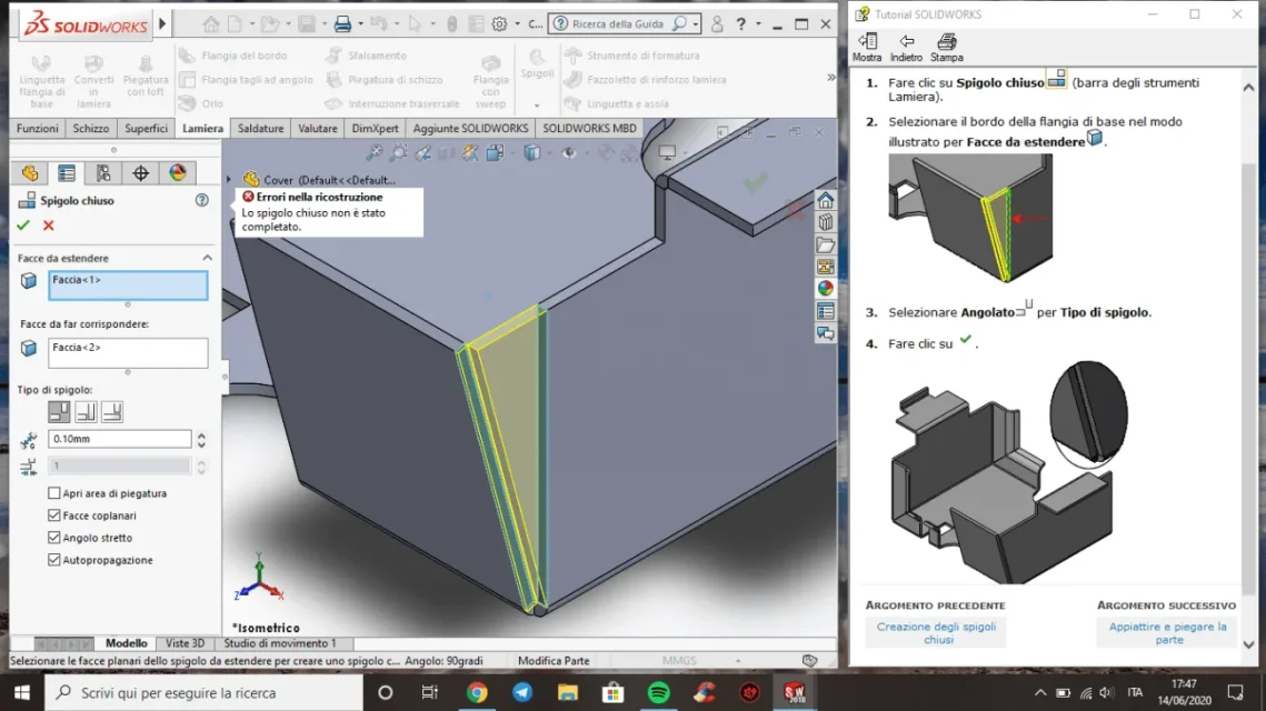

I am a new user here and also on solidworks and I am using the internal tutorial just to solidworks to learn something. I arrived at the sheets and match the problems during the flattening of the sheet, the creation of the sketch bending and the creation of closed edges, even if I followed their tutorial, what can I have wrong?

in addition to the problem of flattening, I also solved that of the sketch bending; But I can't solve that of the creation of closed edges. He doesn't tell me what error he finds, he just tells me that the edge was not created

until tomorrow I cannot see your files; But I repeat to you to analyze every single function and every single option in it contained with my file.
at the end of the feature manager there is a bar, click on it and drag it up, in this way you will suspend all subsequent functions and you will be able to individually focus one by one.
when you want to understand where there is a possible error this is an analytical passage to do.
then:
function :1 settings your vs my settings: ok steps to function 2, no ok fixes and steps to function 2
so for each function
I have checked and that function to me applies without problems; I don't know if it's a bug in your version and service pack.
the geometric difference, which you did not see, between our two versions lies in the direction of the sheet compared to the initial sketch.
so while you kept 180 outside I kept it inside, but it has no implications in later functions
