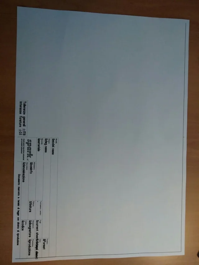

I did what you said. Then I printed and in the image attached, you can see how I see the table.
foil a3 297x420 seems to be scented. Is that normal?
depends on 2 factors: paper size and position of print origin.
if you have made the square as an a3, but use a sheet exactly a3 (not oversized) edges come by force cut.
if you also have an oversized sheet, but the edges remain cut, check in the format, that the lower left corner, correspond to the origin.

I found it. The origin is fine. But I only print the upper and right margin.

do the test and save it in pdf, if it remains decentralized, then it must be modified, if instead the pdf is correct, it is the fault of the settings of the printer/card.
if I export to pdf, the internal team is seen. but remains decentralized of 1/2mm. Also known that the scale is not 1:1 as it comes if instead molded directly from creo.
I'm sorry, but with "then changed" what do you mean?
in your case then it is the centering that does not go and you have to move the format of the distance you notice.
If the pdf scales you, it means that the paper you use, is too small for the format, if you have a printer for the a3 to give to the production, you have to narrow the format to make it stay inside, so you have the scale 1:1, or use an oversized paper size.
for now I have changed the inner pane, narrowing of 5mm. But I know I have to get up of 1mm and move forward of 1mm.
Should I move the format or origin?
