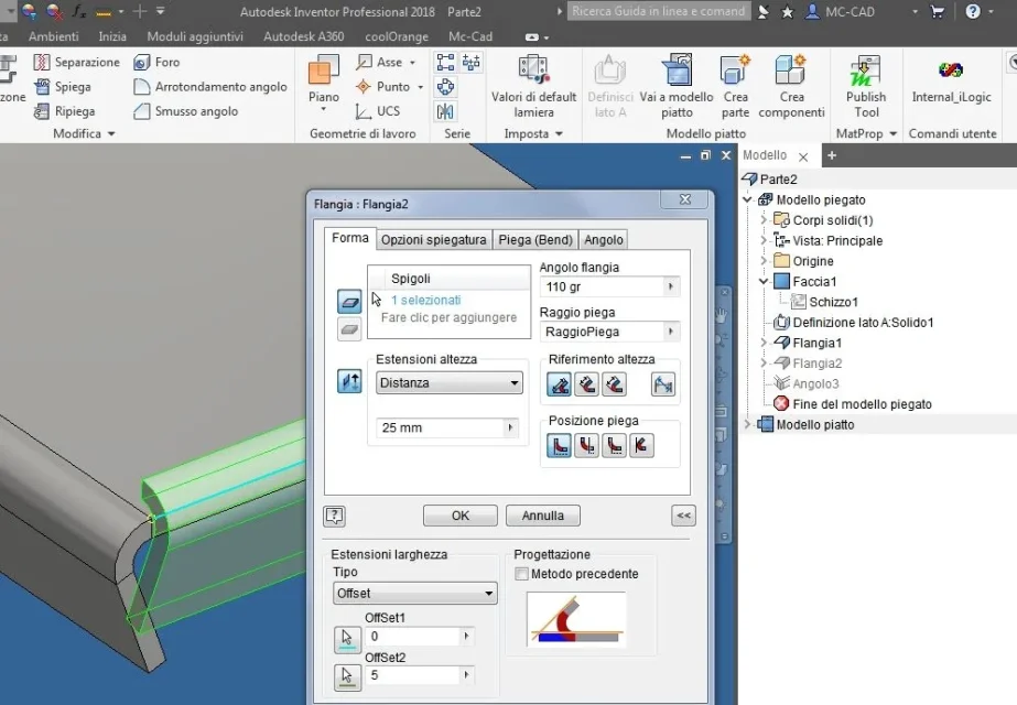

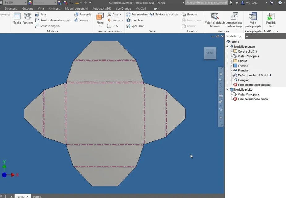

I went from inventor 12 to 17... and now if I make this fold I go into interference... is there any settling to avoid this?
Cattura.webpgrazie

I don't remember the 12 doing everything automatically.
I'd do that anyway. .

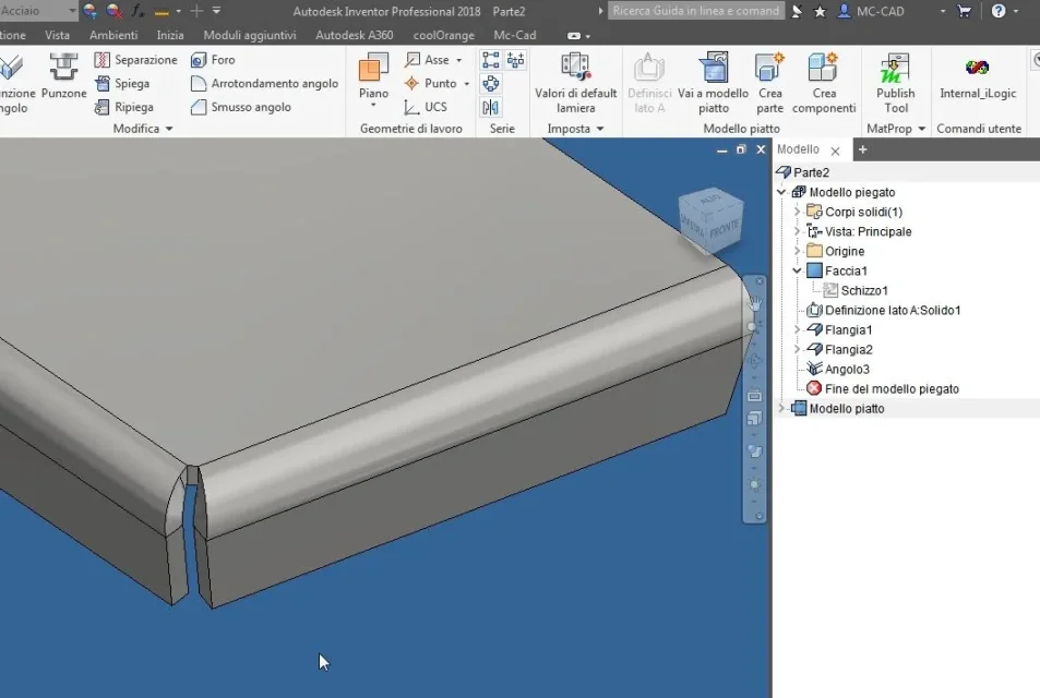

1st) in case you fold at a time
make 1st fold and then the 2nd do +corta and then join it with angle joint

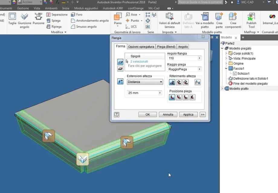

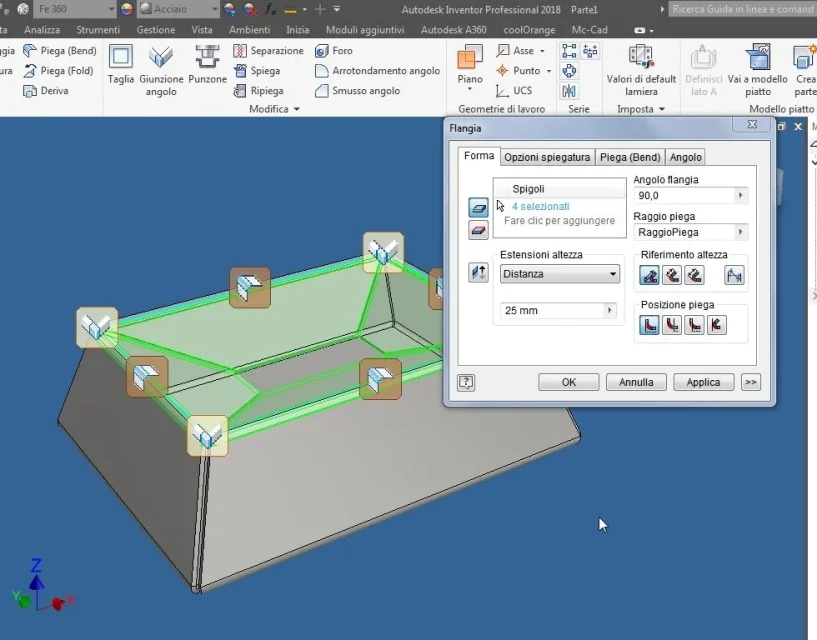

_foto__137.webp2°) or make the folds simultaneously by selecting + edges at a time

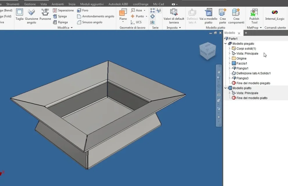

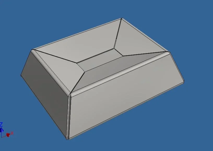

_foto__138.webpThis way it is all automatic
aaaaa here ... it was enough to make the flanges in sequence ... I did not remember it ... or the angle joint as you say. Thank you!
