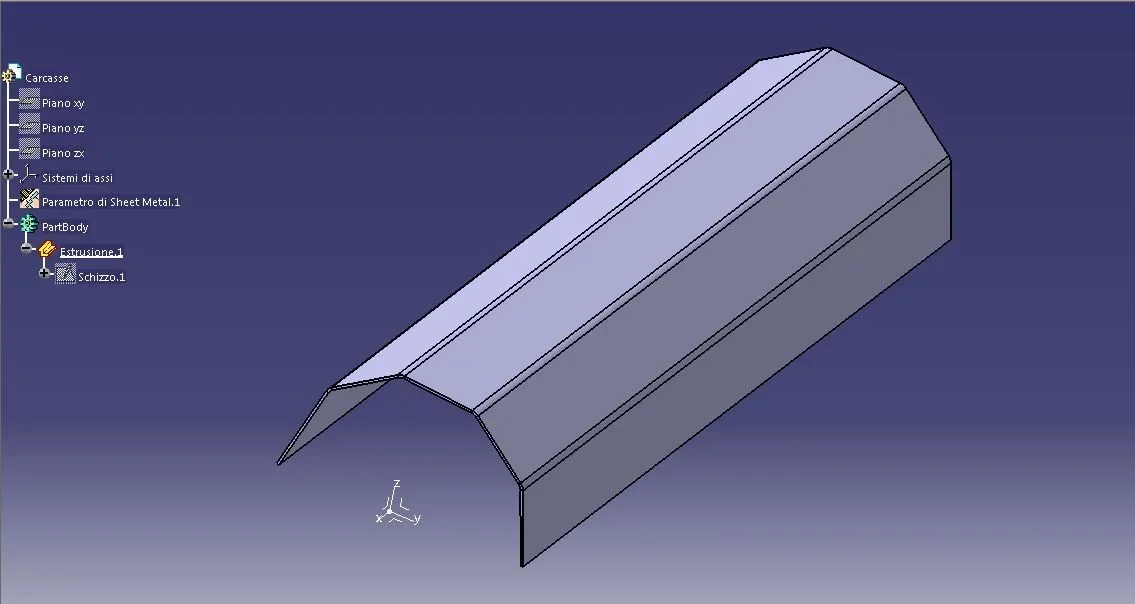

Hello everyone,
It's been a while since I haven't placed anything.:biggrin: as usual I have a little trouble. I made a semi-open cassone (see attachment_1). as such cassone is a folded sheet, I relied it in sheet metal design environment so as to have the development of sheet metal. As you can see, I first realized a sketch of the section with the dimensions of the folds and the connection rays and then I extruded in everything getting the dish. made this I used the bending/developing command in the plane and got the developed sheet. so far no problem.:finger: as soon as I peed, I flew the whole thing appeared dimensional "errors", I explain better. on the drawing the developed sheet has different dimensions than the size I gave it in the modeling phase, for example the size of each folded side seemed to be longer than the one I gave with the quotas (as little as 1mm). this has produced a total size greater than 4 mm. I think this is caused by the fact that the sheet has been developed (it has become flat) after being created and not vice versa (i.e. it did not start from a flat sheet and then fold it!). So I found a longer sheet. How can I solve this problem? How can I at least have correct sheet metal quotas before bending?
