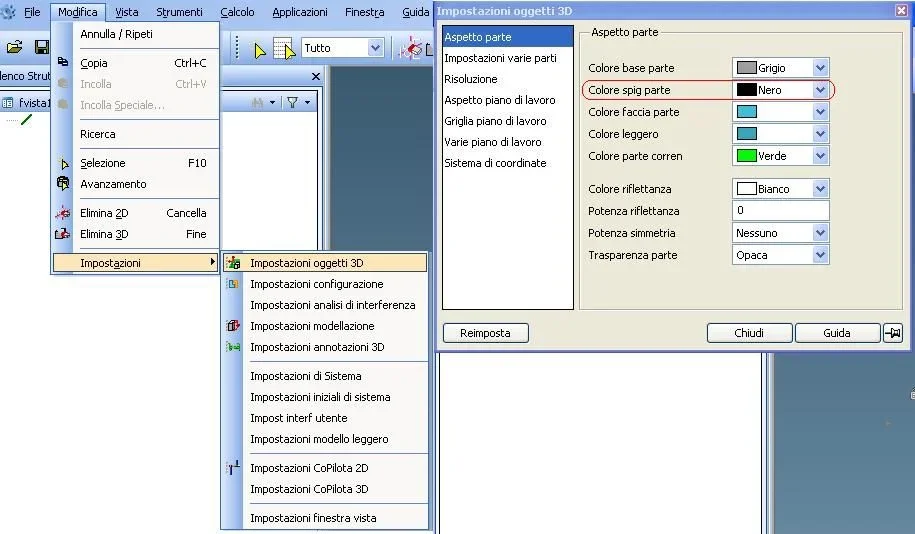

changes a bit from version 17 to 19 but the procedure is the same: you have to change settings and change the appearance part in "Settings 3d objects"
